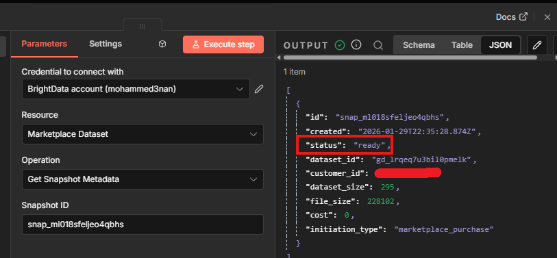

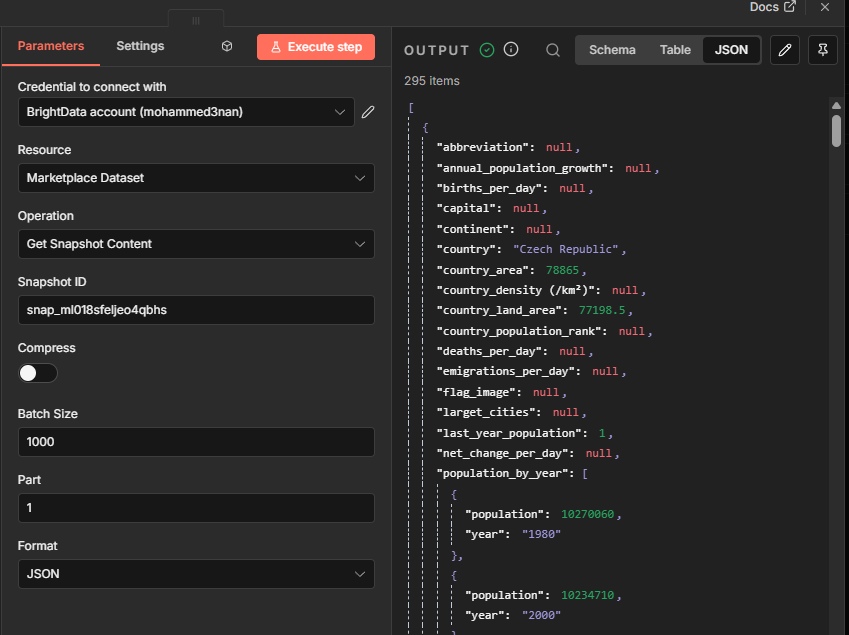

Hi @Sarthak_Kawatra, welcome!
I do get a 502 Bad Gateway at first, but after waiting for a bit until it becomes Ready, I’m able to access the content:

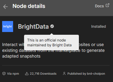

You can try using the community node (it’s verified):
Alternatively, you can use the HTTP Request node, both options should work..
You can also check the status first:
Then add a wait node with a loop until it’s ready, and call the content afterward..
Hey,
Thanks for your solution. I started to use the HTTP node now to scrape the data and then using the verified “Check Status of Snapshot” Node to check if its ready or not. Not sure why the official node does not work for me when I try to scrape a new snapshot but for now this does the work I’m trying to achieve.
I also see in your screenshot that you are fetching the marketplace dataset I’m trying to use other specific web scrapper that I want data from and it does not scrape using the official node yet I believe.
