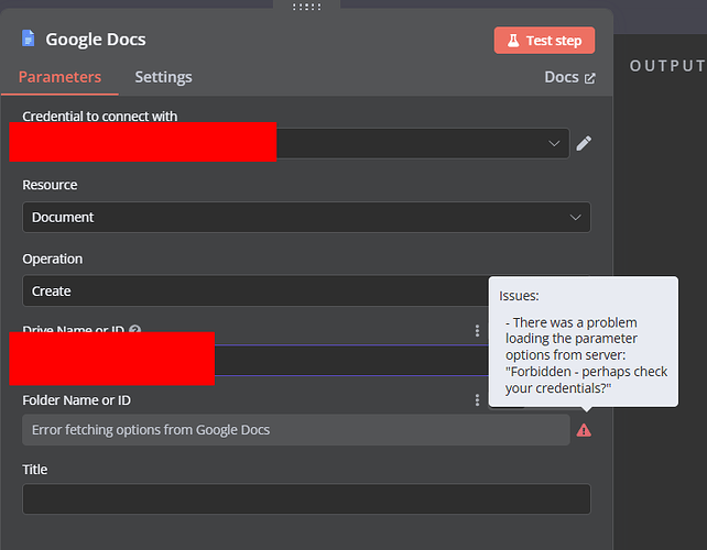

Hi im missing something or i need to set something else for access to shared drive? im acqually manager of that shared drive but it seems i cant retrive contents

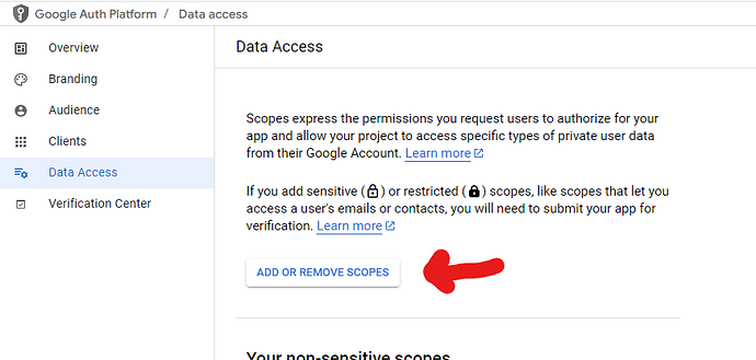

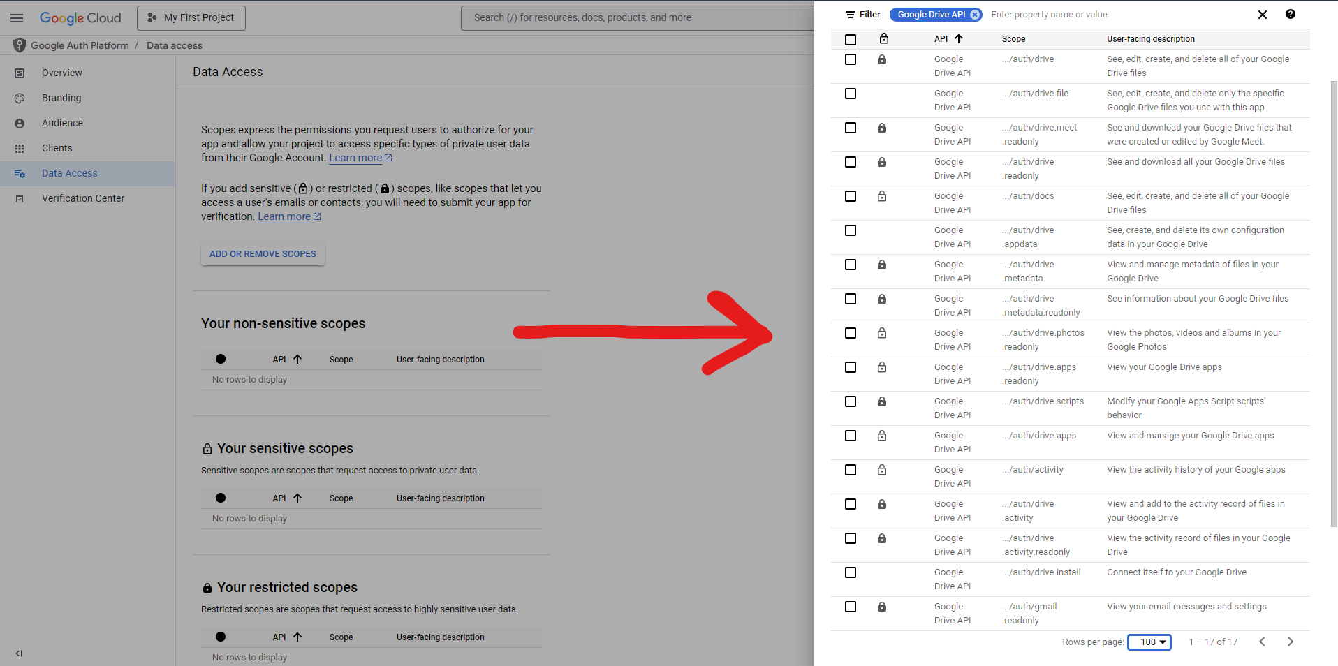

In your Google Cloud Console, make sure you have all the Google Drive scopes listed here:
If you don’t, add them manually.
:muscle: If my reply answers your question, please remember to mark it as a solution.
i have add all scope and try to connect again but not work, not solve the issue

YES it’s a definitely a BUG
Docs Node not supported Shared drives
please maybe @mariana-na helps register a bug to resolve
BUG - Google Docs 2.5 not supported shared drives boolean Query Parameters - supportsAllDrives=true&supportsTeamDrives=true to activate fetch files from the shared drives.
Ahat need to add - Please add two oprions in node
supportsAllDrives=true/false
supportsTeamDrives=true/false
