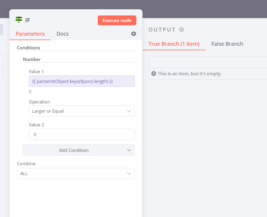

BUG: IF & Switch nodes are malfunctioning
The IF node is resulting in a True when it should be False.
Below is an example of the flow from a live use-case.

Try to equal or more than 1
Maybe check for empty value? i think 0 because empty. Yeah strange.
explicit typecasting doesn’t work either:
Same issue with the Switch node:

Hi @MutedJam , forgot to post an update: i did figure out that the issue isn’t completely with IF/Switch nodes, in this case.
The incoming data isn’t actually empty even though the UI shows it as such (found out after i console logged it).
It appears empty in the UI because the only existing property’s value is undefined.
And that links us back to this earlier reported bug:
So, i think there are 2 issues now:
  1. Misrepresentation of incoming properties & values in the UI
  2. Misrepresentation of non-empty value in the Preview section of the value, in the IF & the Switch nodes.
