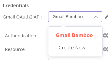

The above documentation link says Gmail can use a service account. Except when I make a service account the Gsuite node only allows Gsuite Oauth Credentials.

Yes, this is a gsuite email with our custom domain.
In the Gmail node, it only allows for oauth credentials in the dropdown.

Hi Jan,
I’m not sure why that isn’t reflected in my setup. I’m wondering if I should just nuke my whole setup and reinstall from scratch… As there have been a bunch of weird anomolies lately…

You have to set “Authentication” to “Service Account”, it is the parameter below the one you have open in the above screenshot.

Oh duh. I can’t believe I missed that. Thank you kindly.
