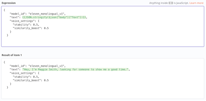

The latest update has broken the JSON.Stringify functionality. It is wrapping anything from that node in an additional [ ] which is breaking API requests which we are reliant on. See attached screenshot.
I am running N8n via Cloudron, the updates which caused this are 1.2.0 and 1.2.1 which happened at 1AM and 5AM automatically for me. I will roll back to previous version until a fix is out for this.
I think this is kinda breaking change for a lot of people who use the JSON.Stringify method in their workflows.

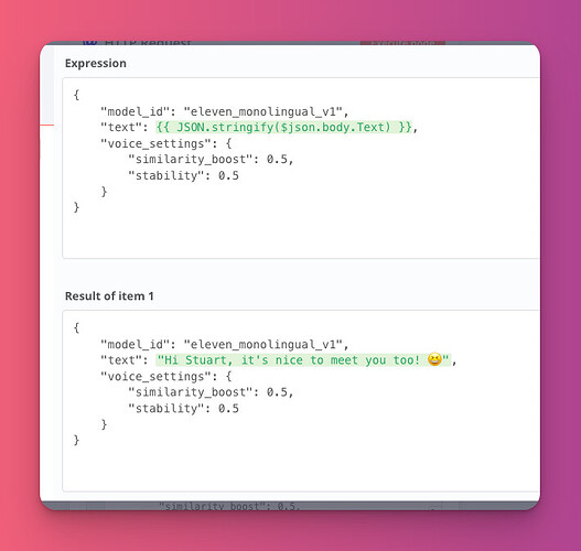

Can you share the incoming data you are using in the webhook? For me using a Set node to set a value and then using the same formatting doesn’t reproduce the same issue so it sounds like maybe the data is going to be key to this one.
At the moment the only way I can reproduce this is by having body.Text as an Array instead of a string and in that case the stringify function is working correctly.

I wish I took some more screenshots before I rolled it back to a previous version but this is a flow we have had live for some time without issue. I checked the logs to debug before I wrote the first report and it happened literally right after the update at 1AM so was working fine before that.
Now that I have rolled back the version it continues to work fine as it did before that update so totally unsure of how to replicate this issue now as I don’t want to break it again.

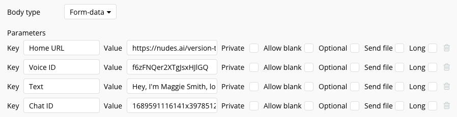

This is a screenshot from my Bubble Database showing the field that we map to then send to N8n so there is nothing strange there.
In terms of the flow, it is fairly simple, I am receiving from the webhook, then immediately doing a HTTP POST to Elevenlabs API and that is where I was getting this issue before. Let me know if there is anything else I can do to help here.

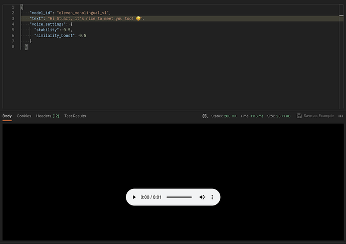

You may need to upgrade again so we can check, From my testing it looks like the issue is with the data recieved so I would need to see that so we can confirm if it is that or something else.

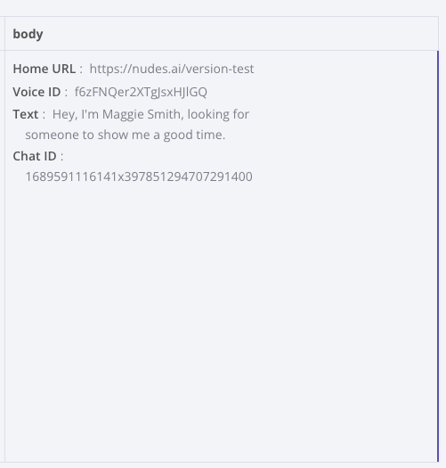

Made a loom video but saw I had a key exposed half way through so if you want that, please DM me or reply to the message I sent to your twitter and I can give access. I have an N8n instance on the same cloudron which I left updated and was able to replicate this by copying the full flow.
I am having trouble with the instance I backed up and rolled back as it is erroring when I try to show a now successful workflow but I have copied the whole thing to a new workflow and ran the same test so this is the rolled back version which works…
Looking at your data you can see that the body is an array for the Text field which is why it has the 0 under it, The good news is this is not an issue with the Stringify function the bad news is this looks to be an issue with the webhook node.
