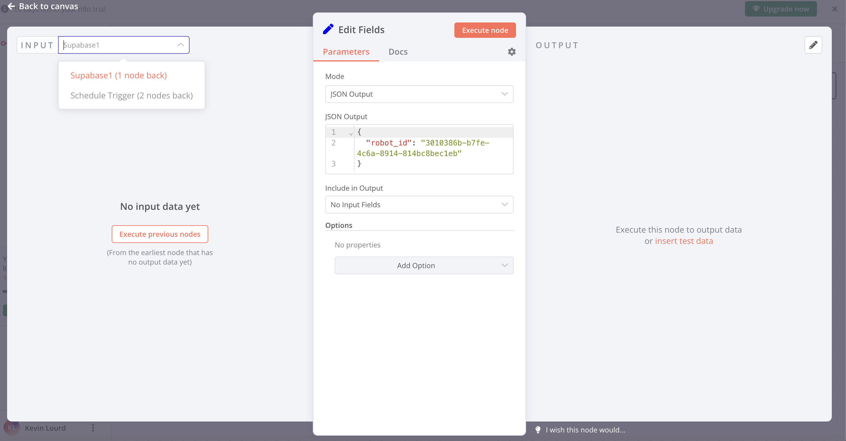

[Bug] Nodes can't Input 2+ nodes back
When I edit a node,
When I choose the Input of that Node
When I select a “2 nodes back” input
Then it does not save with this input.
Instead, it always saves with the “1 node back” input.

Thanks for your quick help @nico-kow!
When I select “Schedule Trigger” (2 node back) and leave the Edit of this Node, then it doesn’t save. Instead when I reopen the Edit I see that the Input is always back to Supabase (1 node back)
Maybe it is a feature and not a bug :wink:
Is my issue clearer now?
Thanks!
Okay I see @Kevin_Lourd,
this is acutally normal behaviour. With that you don’t define the input of that node. You have access to all results of all nodes before. You can think of this as a visual helper to find the data you want and need to access. In the following example you can see that the Result Node has access to all results (outcomes) before.
