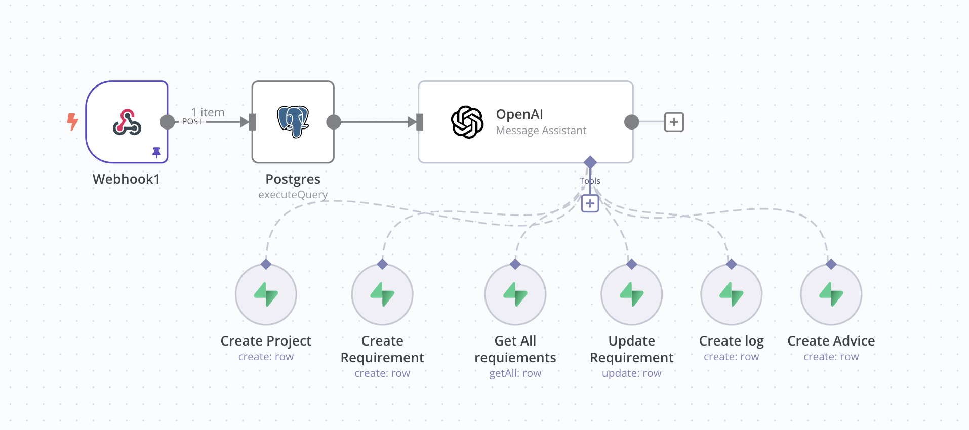

I have simple node with Message to OpenAI assistant and tool - creating record in Supabase. The problem is that Assistant generates multiple tools input, but tool use only first result. I tested it multiple times.

Workaround for now what i did is created a sub workflow for each of my tools and called the sub workflow using Trigger workflow tool.
As i can see in your screenshot,you have multiple tools so this workaround will be a hassle.Compared i had only 2 tools with connected to my agent.

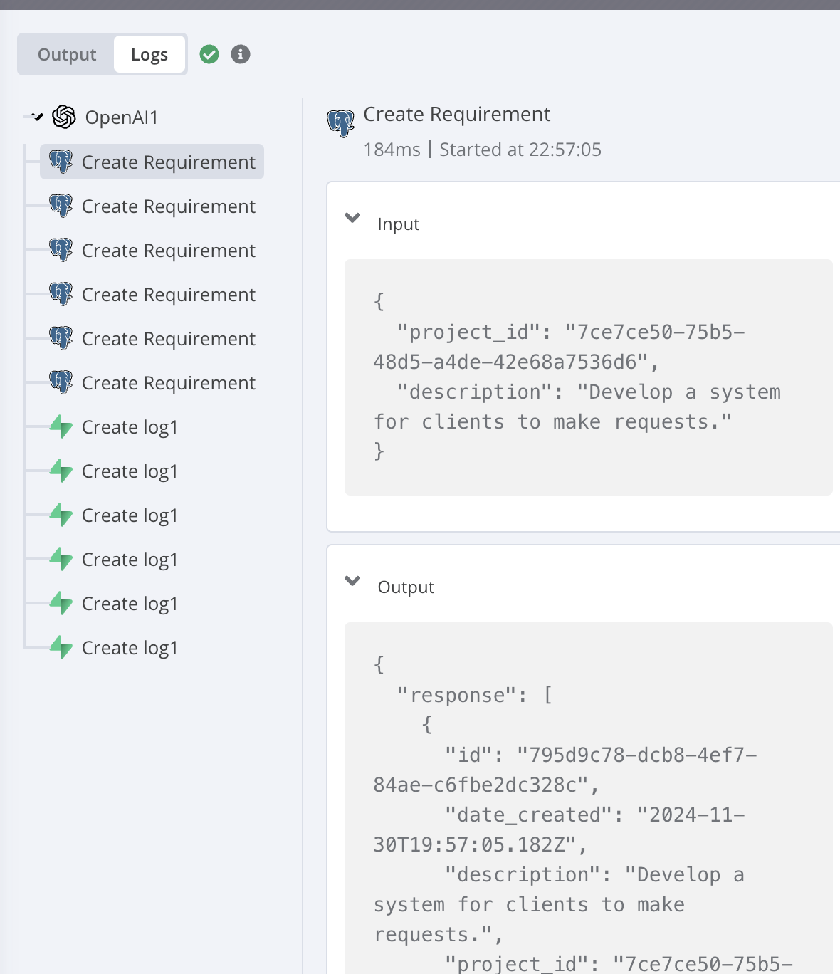

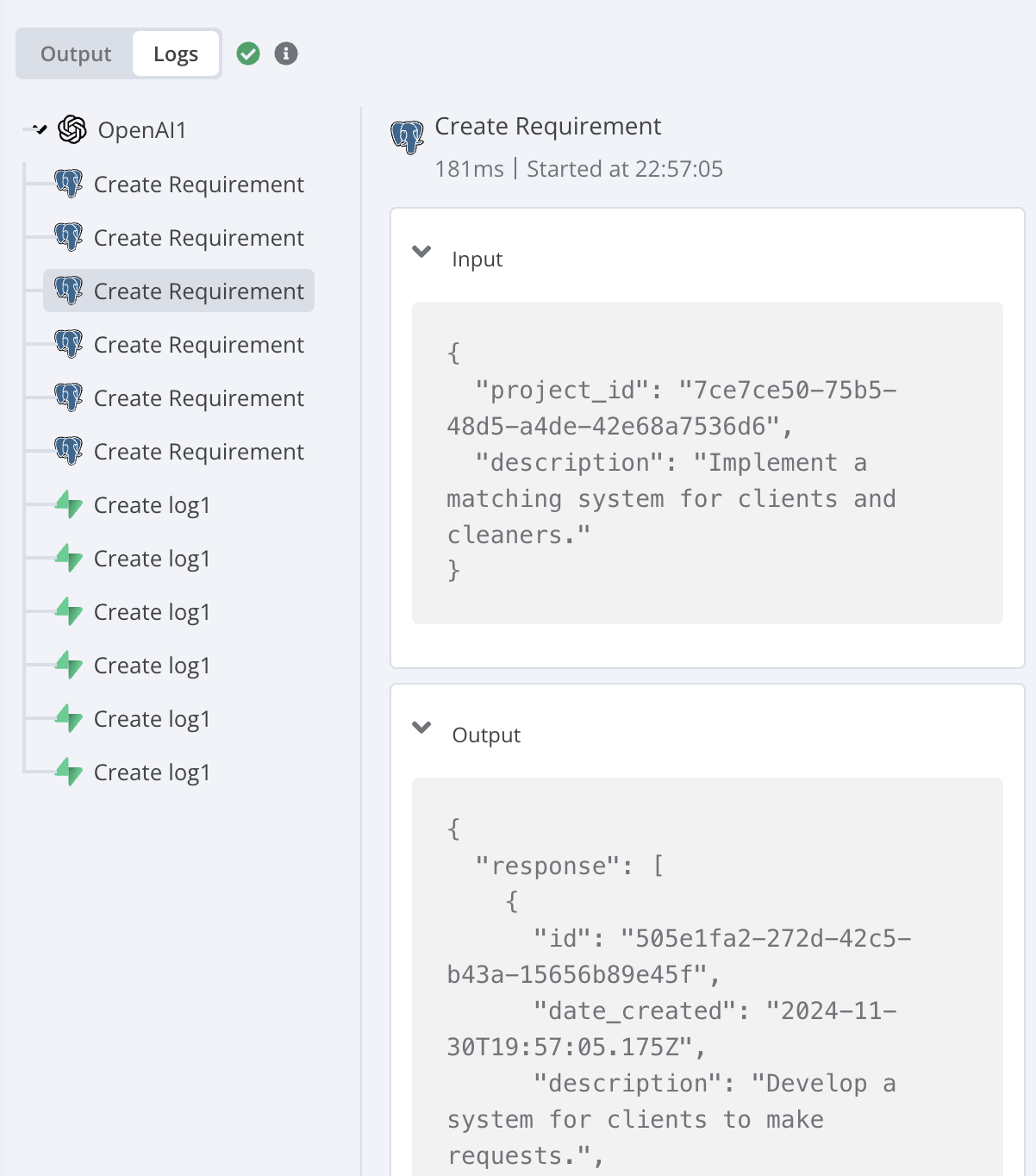

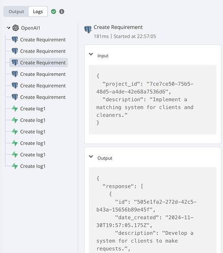

I replaced Supabase node with PostgreSQL and it worked but now the same but - check on screenshot the output is the same for first and all other runs - input isn’t.
@Mark_S have you tried what @AasimK suggested? Also, just fyi I think this is the related post that @AasimK is referring to: Issue with Node as Tools calling several times with the same arguments - #13 by Baptiste_JACQUEMET
Yes, my problem is related to this topic.
I know that I can use sub-workflows but the thing is to use tools for AI agent.
