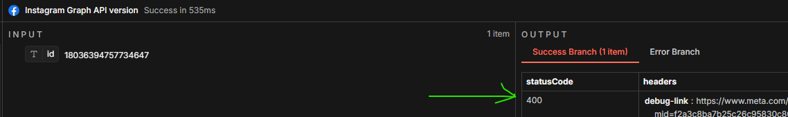

In n8n when the instagram graph api returns http error code 400, n8n still considers it a success.
This is wrong, it should have went to the error branch.
See screenshot below.
It should not ignore the “Response Code” by default.
Succes, but should be error branch.

Raise this issue on GitHub from here. Temporarily, add an IF statement right after this node with a logic similar to the quote below until the internal team investigates this.
IF {{$json.statusCode}} IS NOT 200 OR 202

When adding the if, don’t I risk having flows that keep on running forever, if instagram would never return a 200?
How would I handle that best then?
@K_Rens Since the container is already created and uploaded to Meta API this node should succeed after a couple of tries. However you can use a Switch node instead, and continue the workflow depending on the error message; e.g. if the error message is about permissions, stop and error instead of looping.
