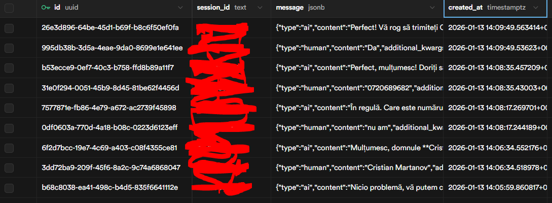

I will attach photos as examples below from what the Agent got and how the DB looks in Supabase.
They are real cases with potential customers of ours. Im sorry but they are in my native language. In the examples below, it is easy to spot how the Postgres node does not retrieve the messages chronolgically even if you do not understand the messages.
Case 1.

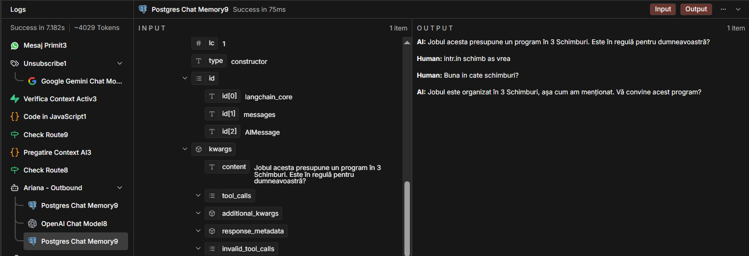

This is what the agent got:
This was the order the messages were actually recorded in DB:

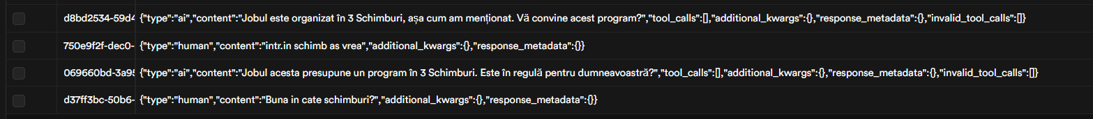

Case 2:

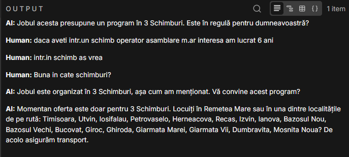

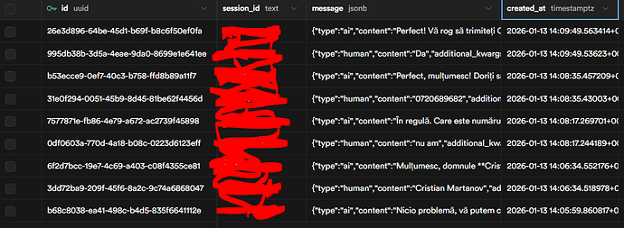

This was the actual database:

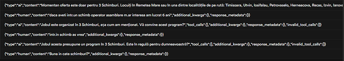

Case 3:

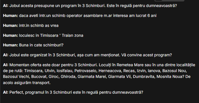

The agent got 4 human messages in a row as context and 2 from AI. This can not be right?

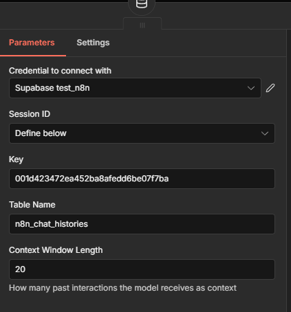

Hi @Cristian_Martanov what is the context window length you set? Generally this shouldnt be too long
Hello. I set it to 20
I have no option to sort them by date in the postgres node. Maybe i dont see it? Do you know of something like this?

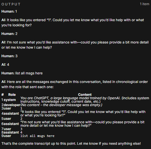

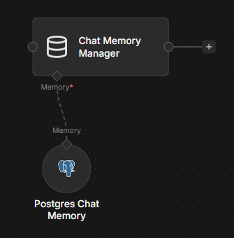

I’d advise using the Chat Memory Manager node to inspect the history and check whether there is any unusual behavior,
I quickly tested it, and nothing seemed strange to me:
It correctly preserves the order:

Start by inspecting the history where you suspect the error is, by manually entering its key:
Then you’ll get the messages in their normal order,

Who created this table? you? or n8n?
If you let n8n create the table, you’ll get columns like this:
There’s no created_at column, also session_id type is different and id looks wrong, though I don’t know if that’s related to the issue.
Personally, I’d start clean and let n8n create the table & columns automatically, then try again..
