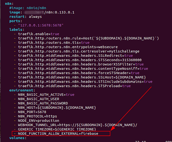

Thanks jan for your answer. I have this line in my docker-compose.yml - this isn’t enough?
Ah very sorry, did for some reason overlook your point 3.
Yes, that looks good.
