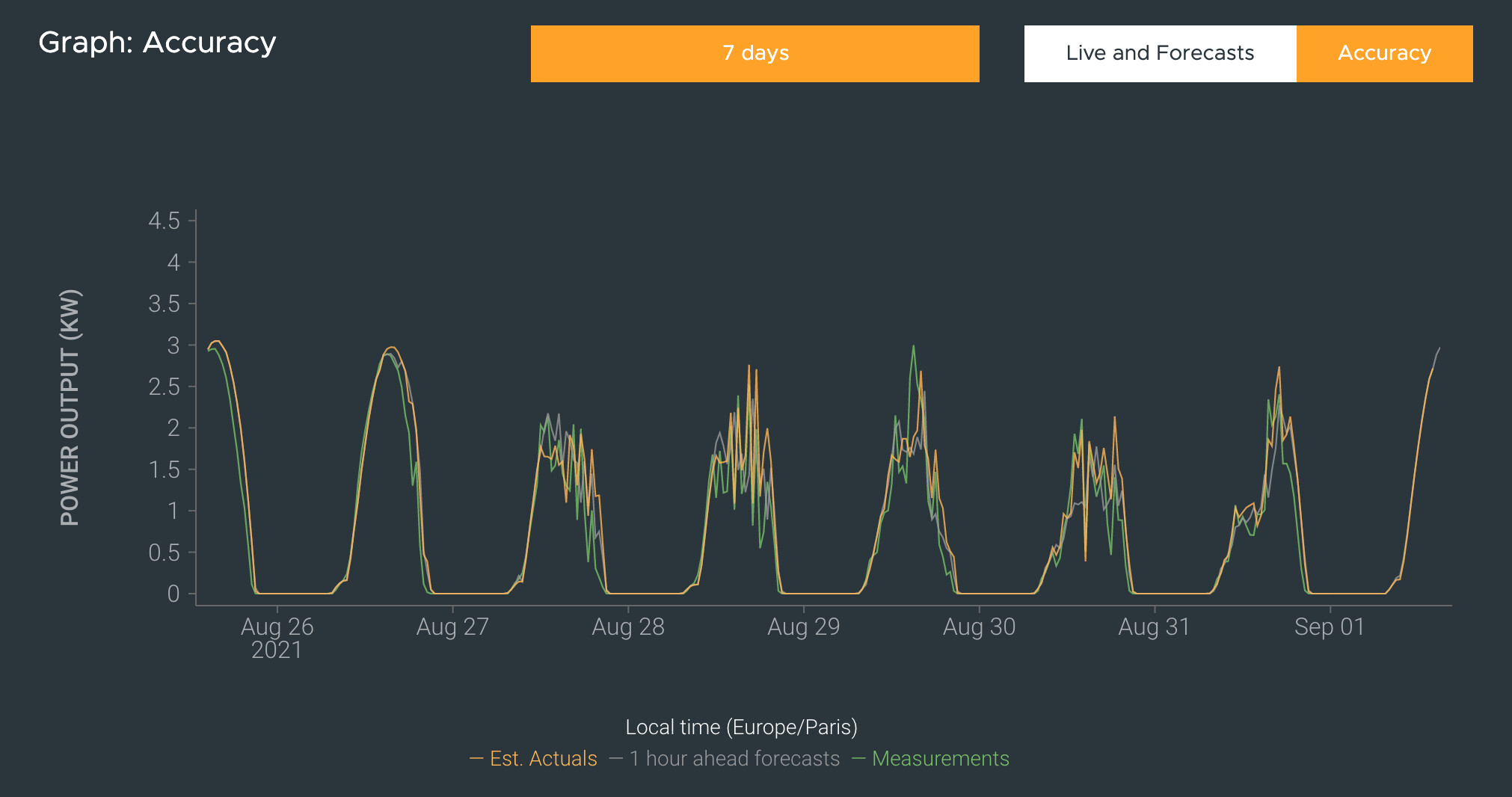

Thanks to you help yesterday, I’ve been able to build a pretty cool flow to request a Solar Measurement API at Solcast.
At the end of my workflow, I have a table with a lot of line of that kind in a nice json format:
