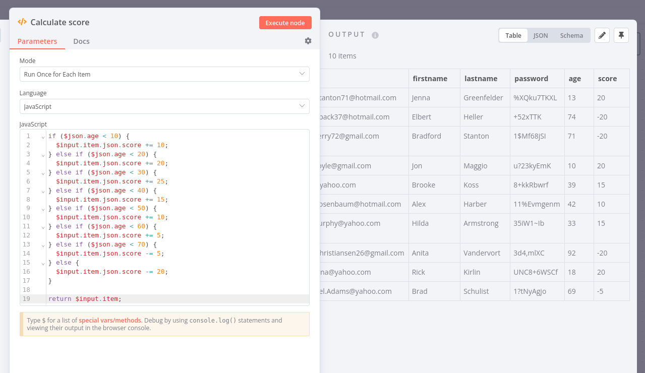

From looking at your screenshot I suspect each Set node is indeed just adding or subtracting points? This would easily be doable in a Code node as well and is probably how I’d implement it seeing the number of different options.
Here’s a quick example workflow that adds or subtract points depending on an age value from an incoming item:
It simply uses vanilla JS along with n8n-specific variables like so:
if ($json.age < 10) {
  $input.item.json.score += 10;
} else if ($json.age < 20) {
  $input.item.json.score += 20;
} else if ($json.age < 30) {
  $input.item.json.score += 25;
} else if ($json.age < 40) {
  $input.item.json.score += 15;
} else if ($json.age < 50) {
} else if ($json.age < 60) {
  $input.item.json.score += 5;
} else if ($json.age < 70) {
  $input.item.json.score -= 5;
} else {
  $input.item.json.score -= 20;
return $input.item;
Adding to or subtracting from the score field based on the age value and the returning the following result:
Hope this helpsl
