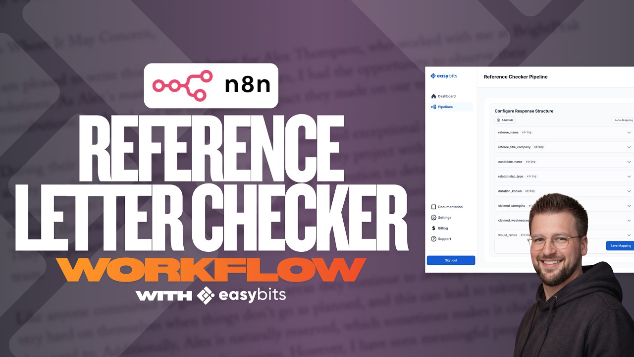

Sharing a walkthrough of the Reference Check Parser I built for Lisa, the recruiter friend of Mike’s I’ve mentioned before. Drop an email with reference-letter attachments into a labelled Gmail folder → workflow reads each letter, scores it, and drops one row per reference into a Google Sheet. Sort by candidate and score and a whole inbox of letters becomes a ranked, scannable table.
:movie_camera: Video walkthrough
