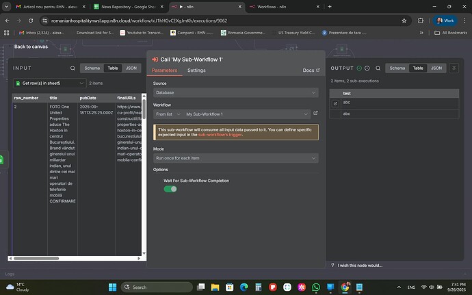

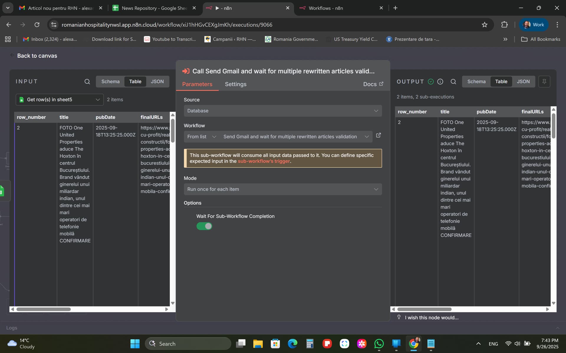

So in the Good (my main case scenario) workflow i have created an execute workflow node that runs the subworkflow for each item in its input and waits for subworkflow completition. Now i have this main case subworkflow scenario where i am taking single items from the parent workflow and i am getting them through a send Gmail and wait for human response as a form node that i have set up as simple as possible after some processing to return this output
“Prompt”:
“asta e al doilea”

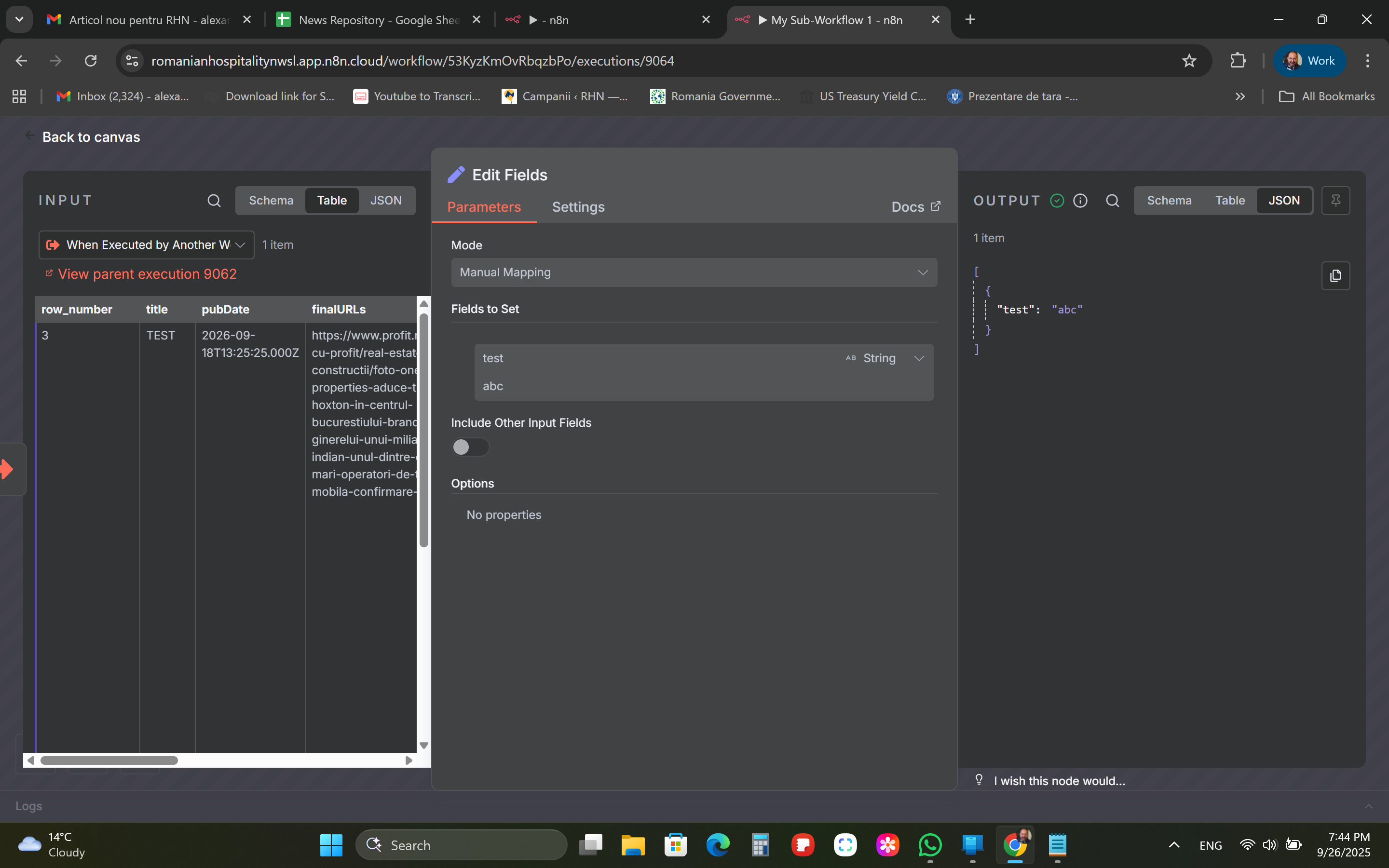

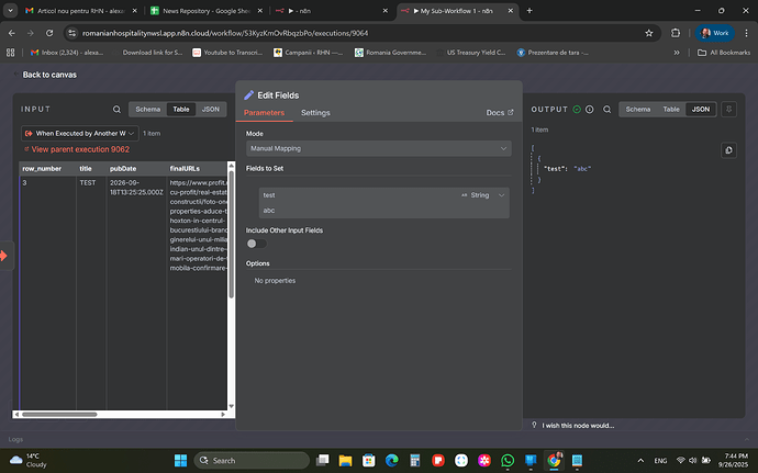

Now i have created a similar execute workflow note that triggers an alternative test subworkflow that is not using the send gmail and wait for response node but just outputs this response as a test:
“test”:
“abc”
so both sub-workflows en with the same kidn of simple output with the same structure.
the problem is that if i run the main case scenario i get the same output as the input and if i run the alternative test scenario i get the collection of two outputs in the right way.
how can i upload the print screens of these two diffrent outcomes of the execute workflow node.

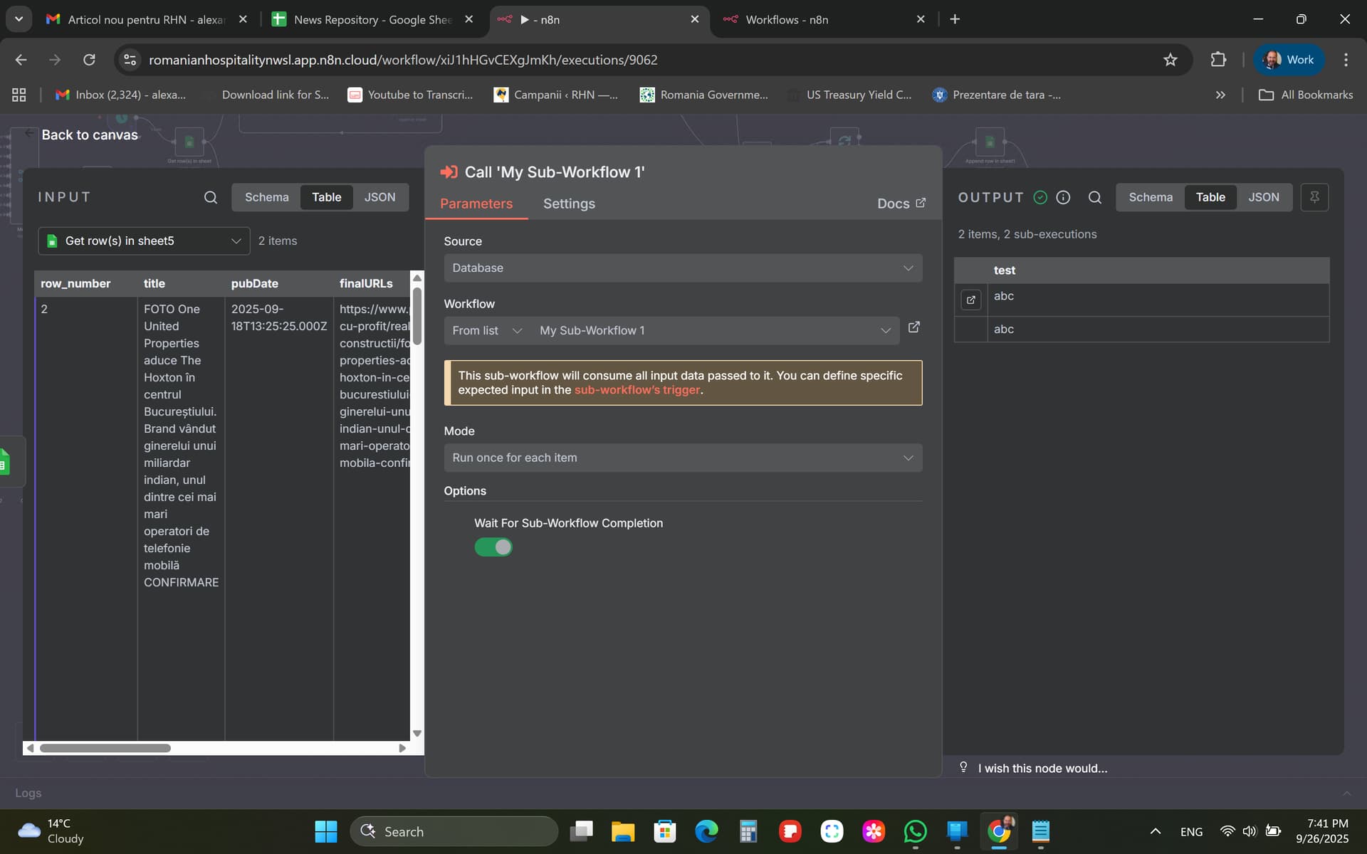

i am executing it in Each mode and instead of receiving this kind of output:
“test”:
“abc”
“test”:
“abc”
i am receiving this output::
“row_number”: 2,
“title”: “FOTO One United Properties aduce The Hoxton în centrul Bucureștiului. Brand vândut ginerelui unui miliardar indian, unul dintre cei mai mari operatori de telefonie mobilă CONFIRMARE”,
“pubDate”: “2025-09-18T13:25:25.000Z”,
“finalURLs”: “link1”,
“articles”: “[“FOTO One United Properties aduce The Hoxton în centrul Bucureștiului. Brand vândut ginerelui unui miliardar indian, unul dintre cei mai mari operatori de telefonie mobilă CONFIRMARE | PROFIT.ro”]”,
“ImageURLs”: “link2”,
“NewTitle”: “Brandul hotelier The Hoxton intră pe piața din România prin One United Properties”,
“NewArticle”: “Dezvoltatorul imobiliar One United Properties a confirmat aducerea pe piața locală a brandului hotelier internațional The Hoxton, marcând astfel intrarea unui jucător important pe segmentul de ospitalitate „lifestyle” din România. Proiectul este semnificativ nu doar prin prisma investiției și a consolidării strategiei de diversificare a companiei listate la bursă, ci și prin impactul urbanistic, vizând reconversia unei clădiri emblematice din centrul Bucureștiului, fostul Hotel Muntenia.Noul hotel The Hoxton va fi piesa centrală a proiectului de regenerare urbană One Downtown, localizat pe Strada Academiei, în imediata apropiere a Pieței Universității. Clădirea istorică va fi complet restaurată și transformată într-un hotel cu aproximativ 200 de camere. Pe lângă spațiile de cazare, complexul va include facilități specifice brandului, precum un bar pe acoperiș cu vedere panoramică asupra orașului, un restaurant, un spațiu de co-working sub conceptul „Working From_” și săli de evenimente. Proiectul va integra și restaurantul Cugó, un concept italian dezvoltat de restauratorul Răzvan Cucui. Această investiție consolidează poziția One United Properties, cunoscută preponderent pentru proiecte rezidențiale și de birouri de lux, ca un jucător activ și pe piața hotelieră.Brandul The Hoxton face parte din portofoliul Ennismore, o companie de ospitalitate fondată de antreprenorul Sharan Pasricha, ginerele miliardarului indian Sunil Bharti Mittal, fondatorul gigantului de telecomunicații Bharti Airtel. În 2021, Ennismore a format o alianță strategică cu gigantul francez Accor, devenind cea mai mare entitate de ospitalitate „lifestyle” din lume. Intrarea The Hoxton în București se aliniază strategiei de expansiune globală a brandului, care operează deja locații în orașe cheie precum Londra, Paris, Amsterdam, Roma și New York, fiind recunoscut pentru designul său eclectic și integrarea în comunitățile locale.”
“row_number”: 3,
“title”: “TEST”,
“pubDate”: “2026-09-18T13:25:25.000Z”,
“finalURLs”: “link3”,
“ImageURLs”: “link4”,
“NewTitle”: "Brandul hotelier ",
“NewArticle”: "Dezvoltatorul imobiliar One United Properties a confirmat aducerea pe piața locală a brandului hotelier internațional The Hoxton, marcând astfel intrarea unui jucător important pe segmentul de ospitalitate „lifestyle” din România. Proiectul este semnificativ nu doar prin prisma investiției și a consolidării strategiei de diversificare a companiei listate la bursă, ci și prin impactul urbanistic, vizând reconversia unei clădiri emblematice din centrul Bucureștiului, fostul Hotel Muntenia.Noul hotel The Hoxton "
“row_number”: 2,
“finalURLs”: “link5”,
“ImageURLs”: “link6”,
“row_number”: 3,
“title”: “TEST”,
“finalURLs”: “link7”,
“ImageURLs”: “link8”,
which seems to be the same with its input:
“row_number”: 2,
“finalURLs”: “link9”,
“ImageURLs”: “link10”,
“row_number”: 3,
“title”: “TEST”,
“finalURLs”: “link12”,
“ImageURLs”: “link14”,

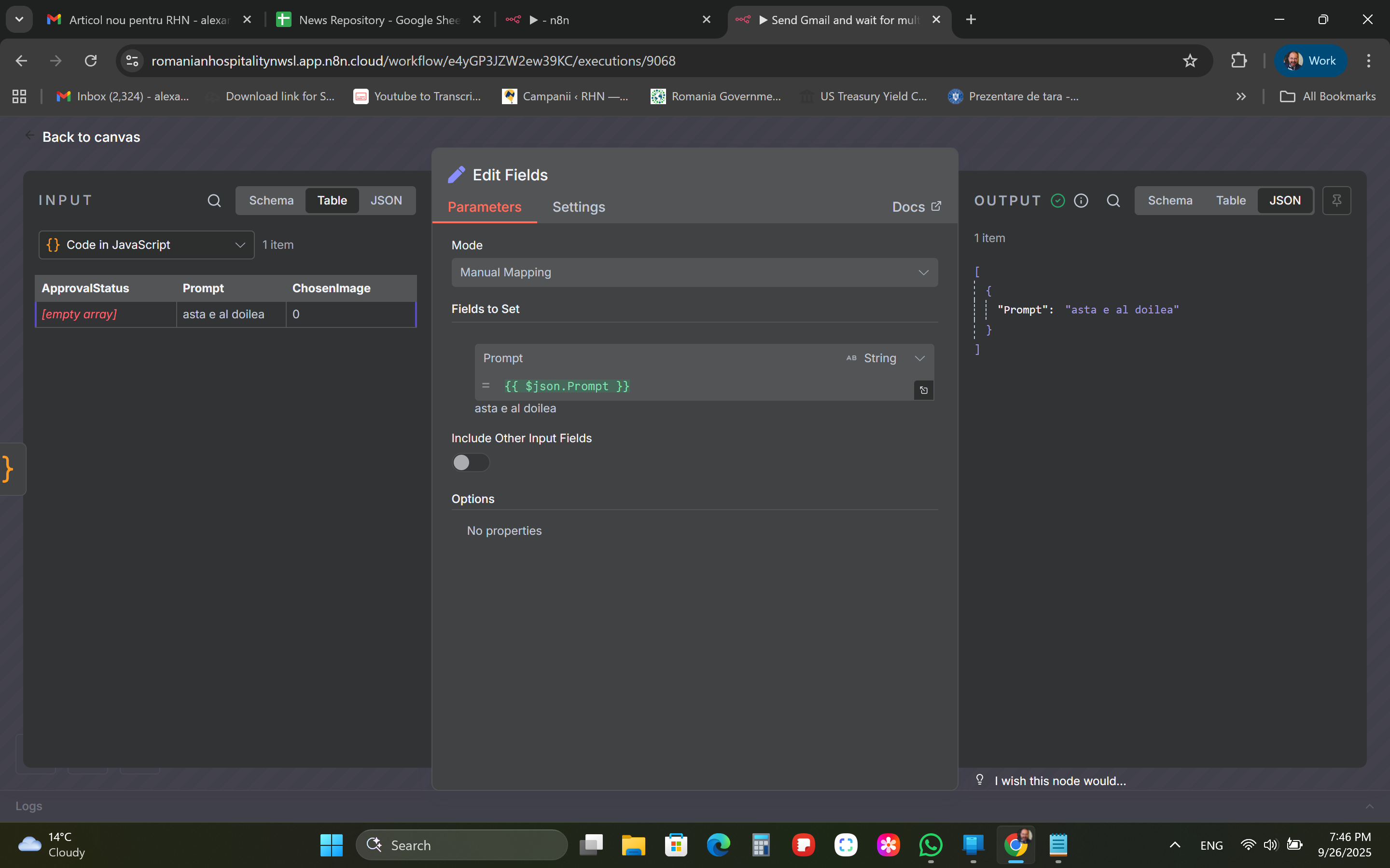

my last node in the main subworkflow is a Set field that sets by mannual mapping one single field that it breings by using an expression like
{{ $json.Prompt }}
the option to include other input fields is not activated and there are no other options for this node

AS
You
the data is coming right in the Set node for that single field i have set up, it is created right after the human has responded to the email in which there was a form collecting data for that field
Assistant
Thank you for confirming that the data is present and correct in the Set node after the human response, and that only the intended field is output.
Given all your checks, the most probable cause is related to how the subworkflow is being called or how the data is returned in “Each” mode. There is a known behavior in n8n: if the subworkflow returns no items for a given input, the parent workflow will fall back to the original input item for that iteration.
Actionable solution:
Check if your subworkflow always returns an item for every input item, even if the human does not respond or the form is skipped. If, for any reason, the subworkflow does not return an item (for example, if the workflow is waiting for a response and times out or is skipped), n8n will return the original input item for that iteration.
What to do:
Ensure that for every input item, the subworkflow always completes and returns a result (even if it’s a default value).
You can add a default value in your Set node to guarantee an output, for example:
Field: Prompt
Value: {{ $json.Prompt || ‘no response’ }}
Reference:
See the Execute Sub-workflow node documentation for more on this fallback behavior.
If you confirm that every input item always produces an output, but the parent still receives the original input, please let me know if you are using any conditional logic or error handling in the subworkflow that could cause an item to be dropped. This will help further narrow down the issue.

when i execute the parent node that launches the sub-workflow it first displays a Waiting for input message in the output window. The suppose i have launched subworkflows for each of the 2 items i had in the parent node on the input side. After i complete the form for the first item the output window of the execute workflow node changes to displaying the entire input window showing both items that were in the input window (on top of the table it says 2 items, 2 sub-executions), when in fact it should have waited for the second item subworkflow to be completed (it should maybe have reported 2 items, 1 sub-execution). Now i completed the secodn subworkflow and looked back into the output window of the parent node and nothing changes there still on top of the table in the output it says 2 items, 2 sub-executions.
——-END of discussion——–
Does the subworkflow has a Wait node ?
Please share workflow(or part of it) in `` between comment marks``` as is easier to debug, instead reading a whole story of a possible “hallucinating” conversation.
Cheers!
I isolated here the parent workflow (links/credentials might not work, i messed with them):
“name”: “SimpleTestWKF”,
“nodes”: [
“parameters”: {
“documentId”: {
“__rl”: true,
“value”: “10o8AGubXf8YkVHduKUpRY2ea1kzoHrDIed1U35pA6kQ”,
“mode”: “list”,
“cachedResultName”: “News Repository”,
“cachedResultUrl”: “https://”
“sheetName”: {
“__rl”: true,
“value”: 487881875,
“mode”: “list”,
“cachedResultName”: “Rewritten”,
“options”: {}
“type”: “n8n-nodes-base.googleSheets”,
“typeVersion”: 4.7,
“position”: [
-448,
32
“id”: “afae1961-1bfc-4799-b52b-71c730a20f17”,
“name”: “Get row(s) in sheet5”,
“credentials”: {
“googleSheetsOAuth2Api”: {
“id”: “CHZ30rHLYNCZIeAb”,
“name”: “Google Sheets account”
“parameters”: {
“workflowId”: {
“__rl”: true,
“value”: “e4yGP3JZW2ew39KC”,
“mode”: “list”,
“cachedResultName”: “Send Gmail and wait for multiple rewritten articles validation”
“workflowInputs”: {
“mappingMode”: “defineBelow”,
“value”: {},
“matchingColumns”: ,
“schema”: ,
“attemptToConvertTypes”: false,
“convertFieldsToString”: true
“mode”: “each”,
“options”: {
“waitForSubWorkflow”: true
“type”: “n8n-nodes-base.executeWorkflow”,
“typeVersion”: 1.2,
“position”: [
-160,
16
“name”: “Call Send Gmail and wait for multiple rewritten articles validation”,
“id”: “b9c83c1c-1c60-4c8e-adf6-920cb90bff79”,
“notesInFlow”: false
“pinData”: {},
“connections”: {
“Get row(s) in sheet5”: {
“main”: [
“node”: “Call Send Gmail and wait for multiple rewritten articles validation”,
“type”: “main”,
“index”: 0
“active”: false,
“settings”: {
“executionOrder”: “v1”
“versionId”: “8dae9ece-1d83-43e8-a939-b142b58dbd96”,
“meta”: {
“instanceId”: “da634db871d8397b9bcc11dca234c732852bd79aaa3b069e5a57ba490e90a171”
“id”: “ghehHuz9oTZyzqas”,
“tags”:
Then here is my subworkflow that does not work right:Then here is my subworkflow that does not work right:
“name”: “Send Gmail and wait for multiple rewritten articles validation”,
“nodes”: [
“parameters”: {
“operation”: “sendAndWait”,
“sendTo”: “[email protected]”,
“subject”: “Articol nou pentru RHN”,
“message”: “={{ $json.NewTitle }}\n{{ $json.ImageURLs.split(’ ||| ‘).map(url => <img src=\"${url}\" style=\"width:100%; display:block; margin-bottom:10px;\" />).join(’') }}\n
\n {{ $json.NewArticle }}\n”,
“responseType”: “customForm”,
“formFields”: {
“values”: [
“fieldLabel”: “ApprovalStatus”,
“fieldType”: “checkbox”,
“fieldOptions”: {
“values”: [
“option”: “Aprob”
“fieldLabel”: “Prompt”,
“placeholder”: “scrie promptul tau pentur imbunatatirea articolului”
“fieldLabel”: “ChosenImage”,
“fieldType”: “number”,
“placeholder”: “scrie aici al catelea link contine imaginea aleasa [link-urile sunt despartite prin semnul |||] daca nici una nu este buna scrie 0”
“options”: {}
“type”: “n8n-nodes-base.gmail”,
“typeVersion”: 2.1,
“position”: [
3136,
1440
“id”: “56fa9567-c431-4268-b486-677cbd464165”,
“name”: “Send message and wait for response”,
“webhookId”: “9986f41d-b88f-4240-a109-0904b86b3fc8”,
“credentials”: {
“gmailOAuth2”: {
“id”: “83mJhtKpBTYPdhmN”,
“name”: “Gmail account”
“parameters”: {
“inputSource”: “passthrough”
“id”: “50fa1894-fb7f-4d65-874a-5d0c1791812c”,
“typeVersion”: 1.1,
“name”: “Start”,
“type”: “n8n-nodes-base.executeWorkflowTrigger”,
“position”: [
2928,
1440
“parameters”: {
“jsCode”: “return items.map(item => ({\n json: {\n ApprovalStatus: item.json.data.ApprovalStatus,\n Prompt: item.json.data.Prompt,\n ChosenImage: item.json.data.ChosenImage\n }\n}));”
“typeVersion”: 2,
“position”: [
3344,
1440
“id”: “6326a8c1-4b92-4107-8e53-34bb38f6dd7f”,
“name”: “Code in JavaScript”
“parameters”: {
“assignments”: {
“assignments”: [
“id”: “6881807a-9393-4406-8abc-9190dad77f27”,
“name”: “Prompt”,
“value”: “={{ $json.Prompt }}”,
“type”: “string”
“options”: {}
“type”: “n8n-nodes-base.set”,
“typeVersion”: 3.4,
“position”: [
3552,
1440
“id”: “646c2547-eaee-41f6-a0f9-d34f9fb5d20f”,
“name”: “Edit Fields”,
“alwaysOutputData”: false
“pinData”: {},
“connections”: {
“Send message and wait for response”: {
“main”: [
“node”: “Code in JavaScript”,
“type”: “main”,
“index”: 0
“Start”: {
“main”: [
“node”: “Send message and wait for response”,
“type”: “main”,
“index”: 0
“Code in JavaScript”: {
“main”: [
“node”: “Edit Fields”,
“type”: “main”,
“index”: 0
“active”: false,
“settings”: {
“versionId”: “711fc711-7d1e-4cfa-9029-fc259a3f0ba5”,
“meta”: {
“id”: “e4yGP3JZW2ew39KC”,
“tags”:
And here is the test sub-workflow that does work right bringing the outcome in the parent workflow:
“name”: “My Sub-Workflow 1”,
“nodes”: [
“parameters”: {
“id”: “c055762a-8fe7-4141-a639-df2372f30060”,
“typeVersion”: 1.1,
“name”: “When Executed by Another Workflow”,
“position”: [
272,
352
“parameters”: {
“assignments”: {
“assignments”: [
“id”: “afd36ef5-9b39-49c4-babd-bdd27e300135”,
“name”: “test”,
“value”: “abc”,
“type”: “string”
“options”: {}
“typeVersion”: 3.4,
“position”: [
480,
352
“id”: “f6bf3916-bee6-458a-91d4-1d3181b27398”,
“pinData”: {},
“connections”: {
“When Executed by Another Workflow”: {
“main”: [
“type”: “main”,
“index”: 0
“active”: false,
“settings”: {
“versionId”: “f5168e14-4ac8-49be-81dd-869e4eda5163”,
“meta”: {
“id”: “53KyzKmOvRbqzbPo”,
“tags”:
