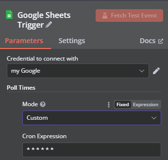

hello @aiandwifi
you can set the custom Cron time for each trigger to not overload the API limits
Actually, it behaves the same way as the schedule trigger node + a usual gSheet node
I’m aware that I can use cron, but the problem still comes up that all of the workflows trigger at that minute and I also need every workflow to check its sheet every 5ish minutes.

Just set the cron expression to trigger them it that way. E.g.:
  • workflow 1 - trigger every 3 minutes starting from 2 - 00:02:00, 00:05:00, 00:08:00, 00:11:00 - 2-59/3 * * * *
  • workflow 2 - trigger every 3 minutes starting from 3 - 00:03:00, 00:06:00, 00:09:00, 00:12:00 - 3-59/3 * * * *
  • workflow 2 - trigger every 3 minutes starting from 4 - 00:04:00, 00:07:00, 00:10:00, 00:13:00 - 4-59/3 * * * *
Crontab.guru - The cron schedule expression generator
