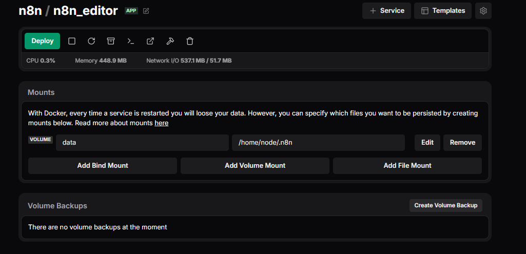

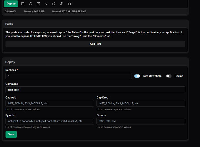

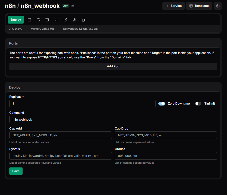

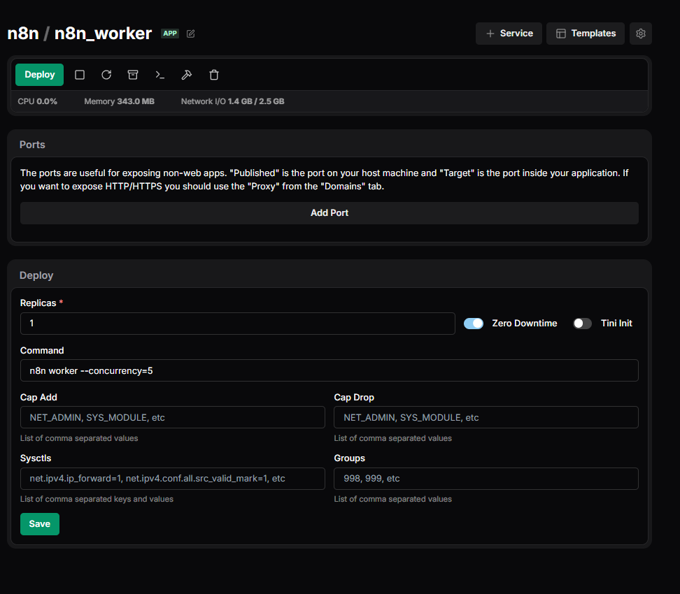

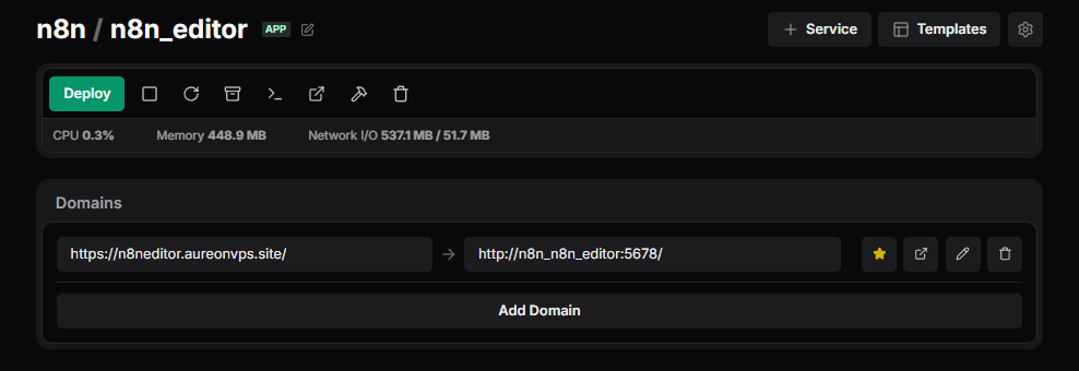

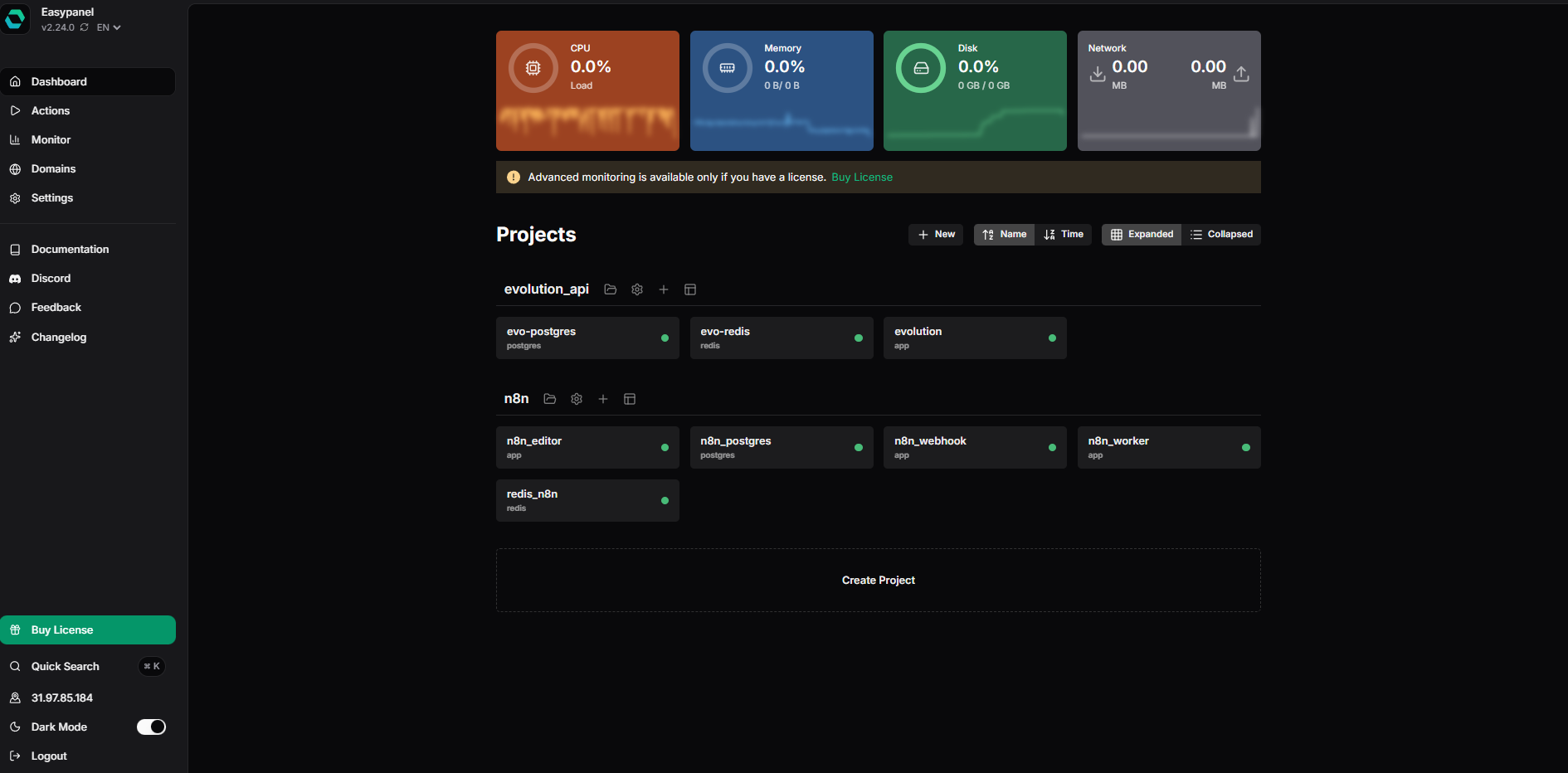

Debug Info
n8nVersion: 2.2.4
Platform: Docker (self-hosted)
Node.js: 22.21.0
Execution mode: scaling (single-main)
Database: Postgres
License: Community
