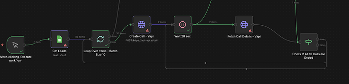

I’m building an outbound calling workflow using Split In Batches with a batch size of 10.
  • Step 1: Split In Batches → creates 10 calls at once
  • Step 2: Wait node → 20 seconds
  • Step 3: Fetch Call Details → checks the status of each call
  • Step 4: When all 10 calls are ended, the next batch should process

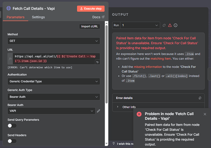

The issue: In the Fetch Call Details node I get this error: Can’t determine which item to use
Expected behavior
I want the Fetch Call Details node to correctly loop through each of the 10 calls, check their status, and only proceed when all are "ended".

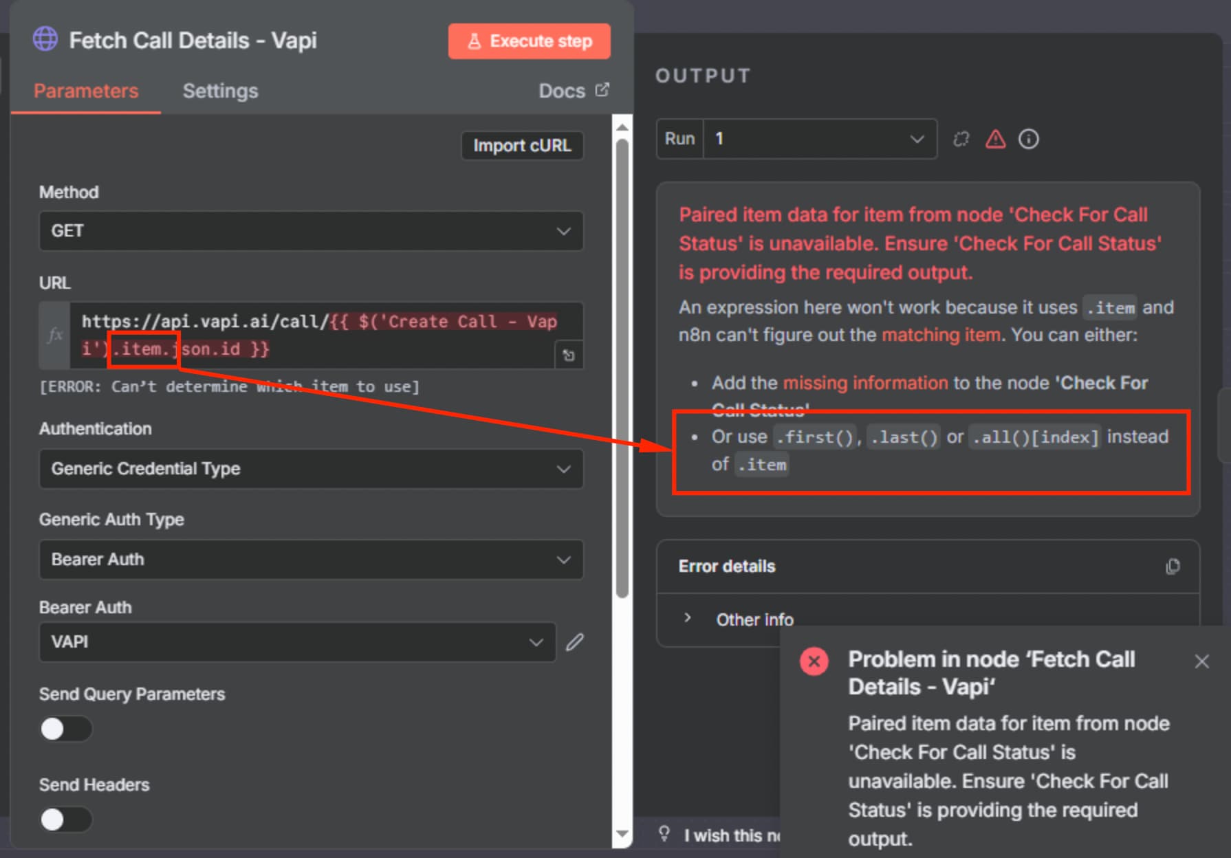

Hi @Muhammad_Hamza_Azhar,
As per the error you need to use “.first()” instead of “.item”
When using .first(), does n8n resolve .first() based on the actual order of call completions, or is it just the first item from the previous node’s output array?

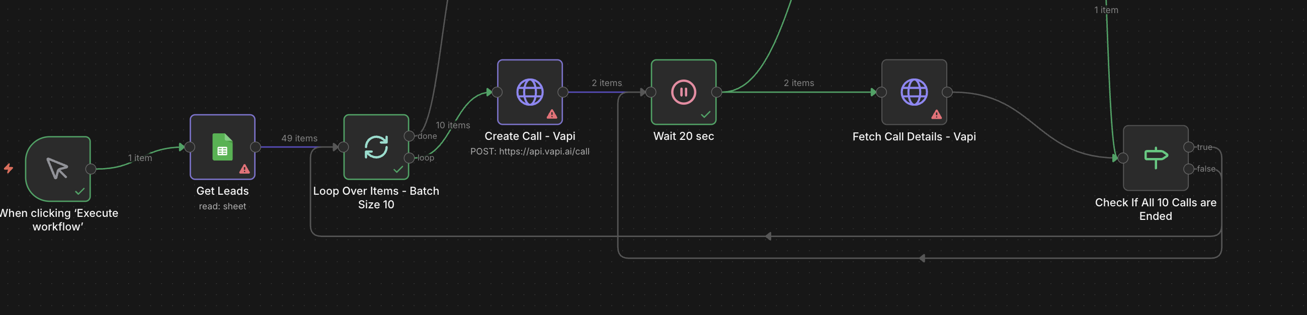

Is it possible to pin sample data for the Get Leads node and the Create call vapi nodes?
Id like to try and run it on my end to check how the data is coming
I have pinned the data in above code, you can check
Ok I found the issue. The error occurs when the IF node is not “allEnded” and it goes to wait a second time. Because you now have a nested loop (loop inside a loop), n8n looses track of which item you’re looping for “.item”. This is because you’re semi breaking the loop by by passing the “Create Call - Vapi“ on that second iteration for wait.
Try the following value on the “Fetch Call Details - Vapi“ node and lemme know if this worked:
https://api.vapi.ai/call/{{ $('Create Call - Vapi').all()[$itemIndex].json.id }}
I pinned the data for both the ‘Get Leads’ node and the ‘Create Call - Vapi’ node in the code above.
I came right, check my edited answer above
Alright, how does ‘Split in Batches’ actually work? What I mean is: if, at the IF node, some calls have the status ‘ended’ while others do not, the workflow goes back to ‘Wait’ and then checks the call status again using the ‘Fetch Call Details’ node. This means the fetch node will re-check all 10 calls, including those that already had the ‘ended’ status. How can we change the workflow so that once a call has the status ‘ended’, it is not checked again?
Your assumption above is correct. To change the behaviour see if you can add a query on the “Fetch Call Details - Vapi“ to find items where not ended status. This MIGHT cause some problems but worth a try. If not, then we’ll to think about this more and try work an alternative flow.
For this Ill need more context on what Vapi is, what the ended status entails and what you’re trying to achieve in your logic. For example, why are you waiting for all batch iterations to have an ended state?
@Wouter_Nigrini Vapi is a platform that allows us to build Voice Assistants, and through their API I am making outbound calls to potential leads. I am waiting for all batch iterations to finish because Vapi has a concurrency limit of 10 - meaning we can only make 10 calls simultaneously. If we exceed that limit, we would need to design a more complex flow. That is why I check for all 10 calls to reach the ‘ended’ status before starting the next batch. If I create a flow to check whether some slots are available, that would also result in a complex flow. To keep things simple, I wait for all 10 calls to end before moving on
Ok that makes sense. Are you able to then add a condition on the fetch for non ended calls only. Then in your code block make sure to check on the returned item count rather, meaning once no records return, they all ended. Then proceed to the next batch.
This should effectively cause your fetches to reduce as the calls end.
So something like below. You can then get rid of the code node
