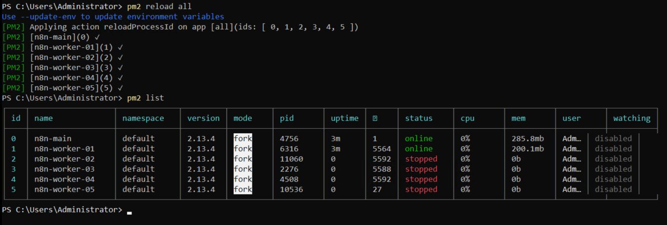

Reloaded the instances ‘pm2 reload all’
No update in error logs, only the out logs go updated.

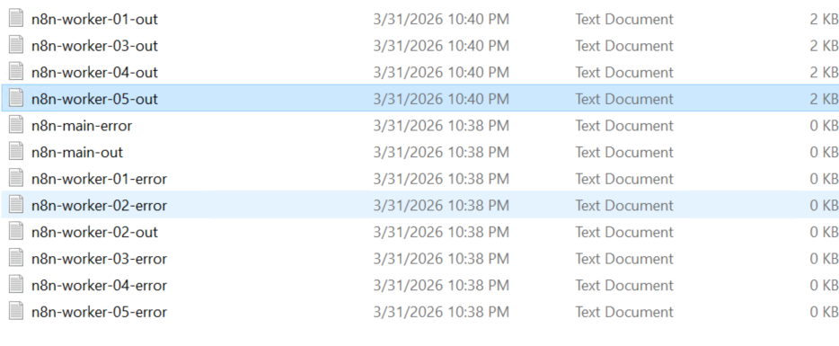

Not able to upload the log files. Here is the latest trace from logs.

All other workers:
Out file has only the below trace.
n8n Task Broker’s port 5679 is already in use. Do you have another instance of n8n running already?

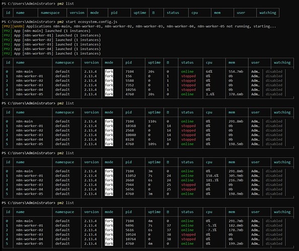

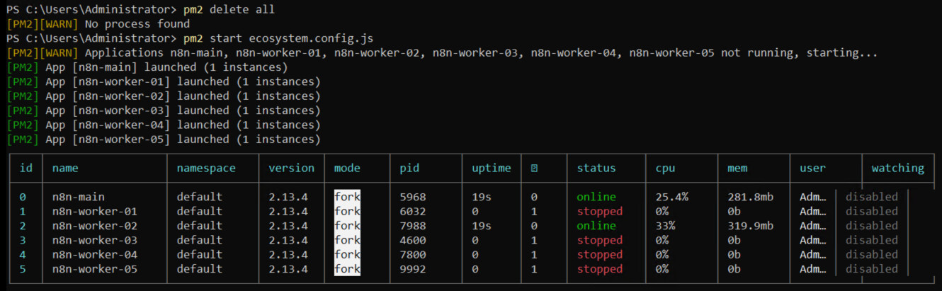

Delete all the process, logs files, and started fresh. Only 1 worker came online. No traces in error logs. Out logs has only the below trace for failed workers.
