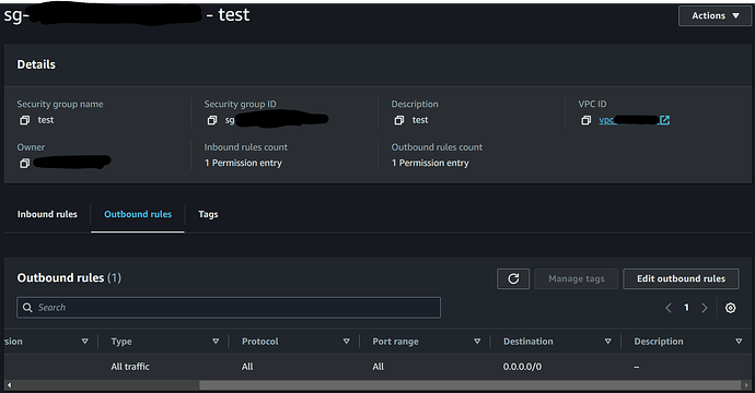

ALB:
Security Group:

Any idea what I could be doing wrong?

hello @fanmixco
  1. You’ll need to register the EC2/Fargate instance to the ALB, not the IP address
  2. You haven’t provided the 443 port rules for the ALB
  3. You haven’t provided the target group details for the 443 port listener
  4. You haven’t provided the security group details for the EC2/Fargate instance that is a host for the ECS service.
  5. I do not see the container configuration

  6. Create Security groups for the ALB and for the EC2/Fargate instance (that will host your ECS containers). For the ALB there will be a ruleset:
    inbound, 0/0 via 443 port
    inbound, 0/0 via 80 port
    outbound, any/any (you can strict it to any/443 and your EC2/Fargate via 5678)
  7. ruleset for the EC2/Fargate:
    inbound, ALB/5678
    Outbound, any/any (you can strict it to the any/443, any/80, any/53)

The solution was not in AWS. AWS was correctly configured, but the domain provider did not have the records from Route 53. I copied the values and added them as NS values with a new subdomain and began to work.
Thanks for your reply, but my AWS configuration was correct. I didn’t change anything I shared before. The domain provider did not have the AWS NS records and that is why it was failing.
Thanks for your reply, but my AWS configuration was correct. The domain provider did not have the AWS NS records and that is why it was failing.
