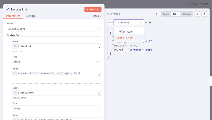

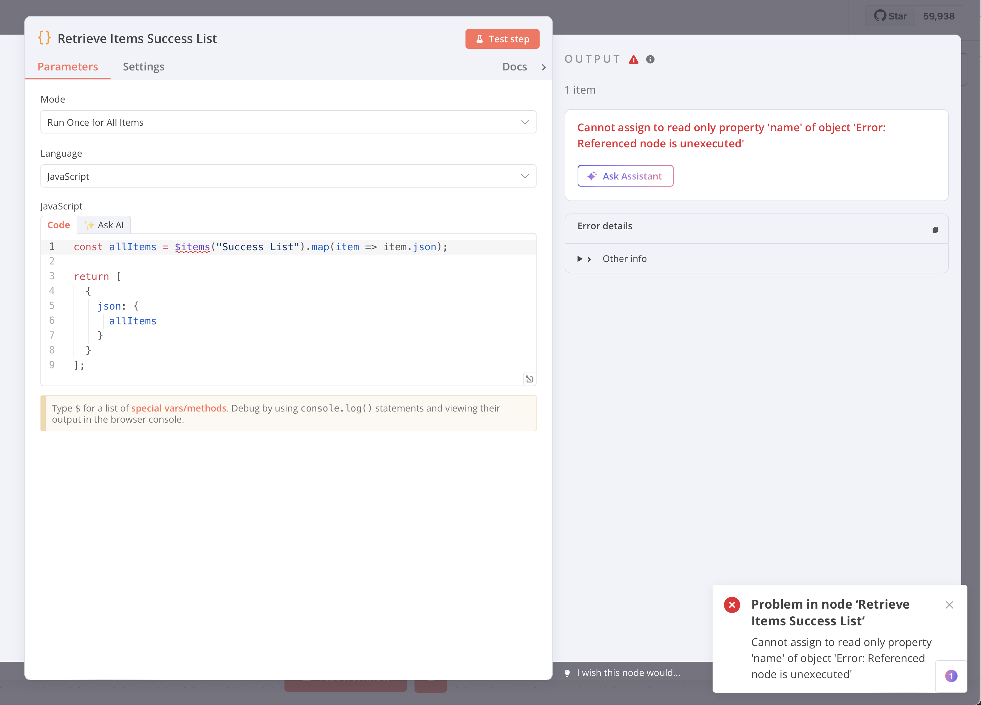

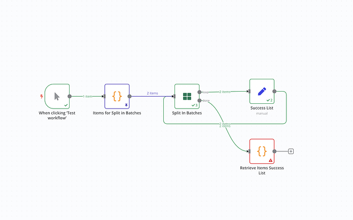

Hello @ihortom , sorry for insisting on this issue, but it’s blocking my project. My suspicion is that $items is no longer able to retrieve items executed within a node inside a Split in Batches. I simulated a very simple flow, where I have a Split in Batches, an Edit node (Success List), and at the final output of the Split in Batches, I have a Code node where I want to retrieve all items from the Edit node. Here is the error message again:
Cannot assign to read-only property ‘name’ of object ‘Error: Referenced node is unexecuted’
This is the same message I got in my first case, which you claimed was a misuse of the HTTP Request node.
Again, for this simple flow, I tested the following codes without success:
const allItems = $items(“Success List”).map(item => item.json);
const allItems = $(“node_name”).all();
const allItems = $node[‘Success List’].json; // Only returns the last item
Crucial question: I just need a code or solution to retrieve all items from a node executed inside a Split in Batches.
P.S.: I’ve always used these codes and never had any issues. This is forcing me to use a database, create a temporary table, and then retrieve these items, which I would never want to do. Retrieving all items from a node’s execution is a critical need.
