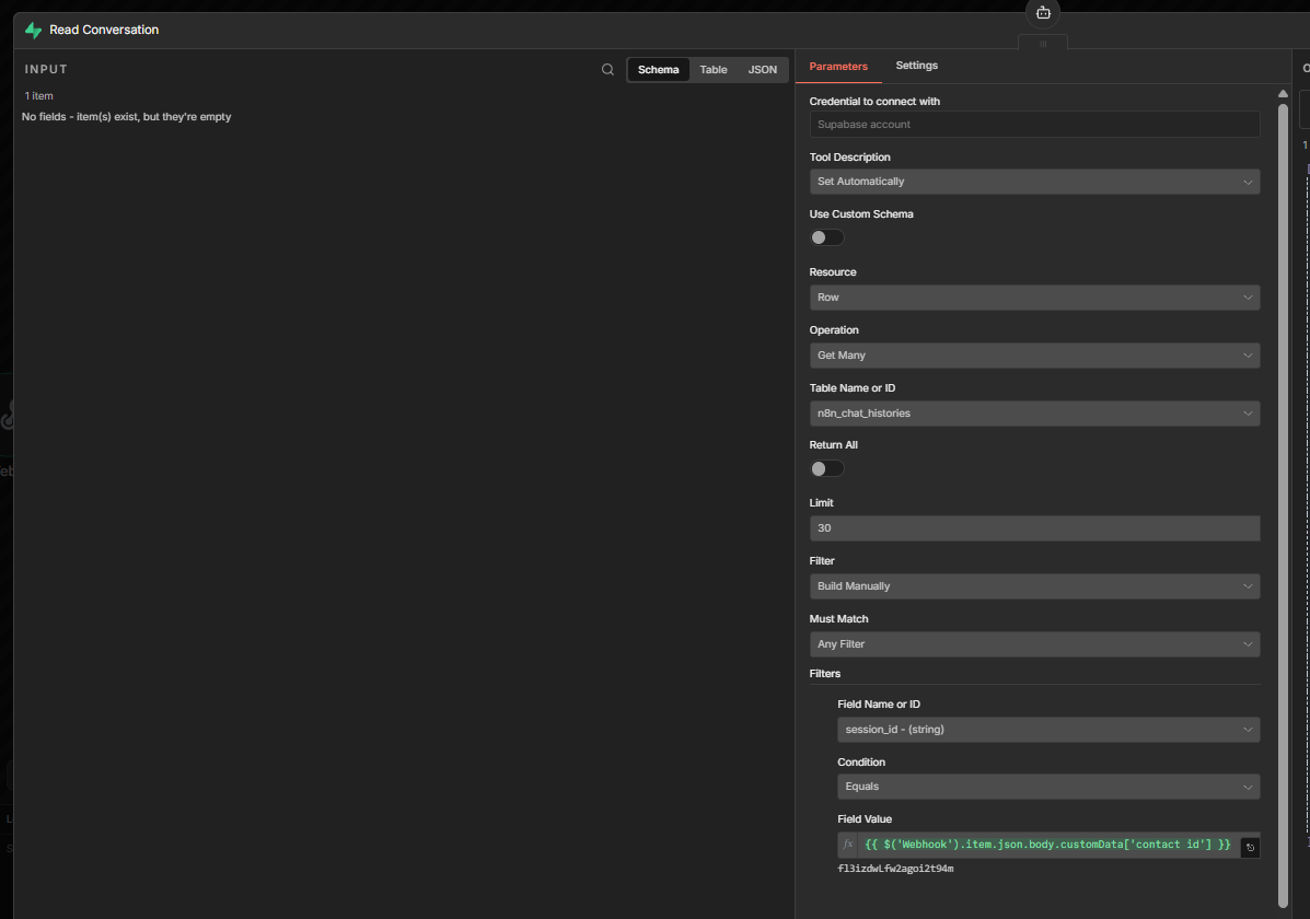

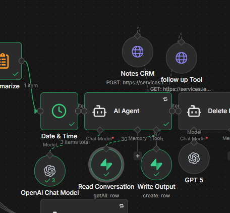

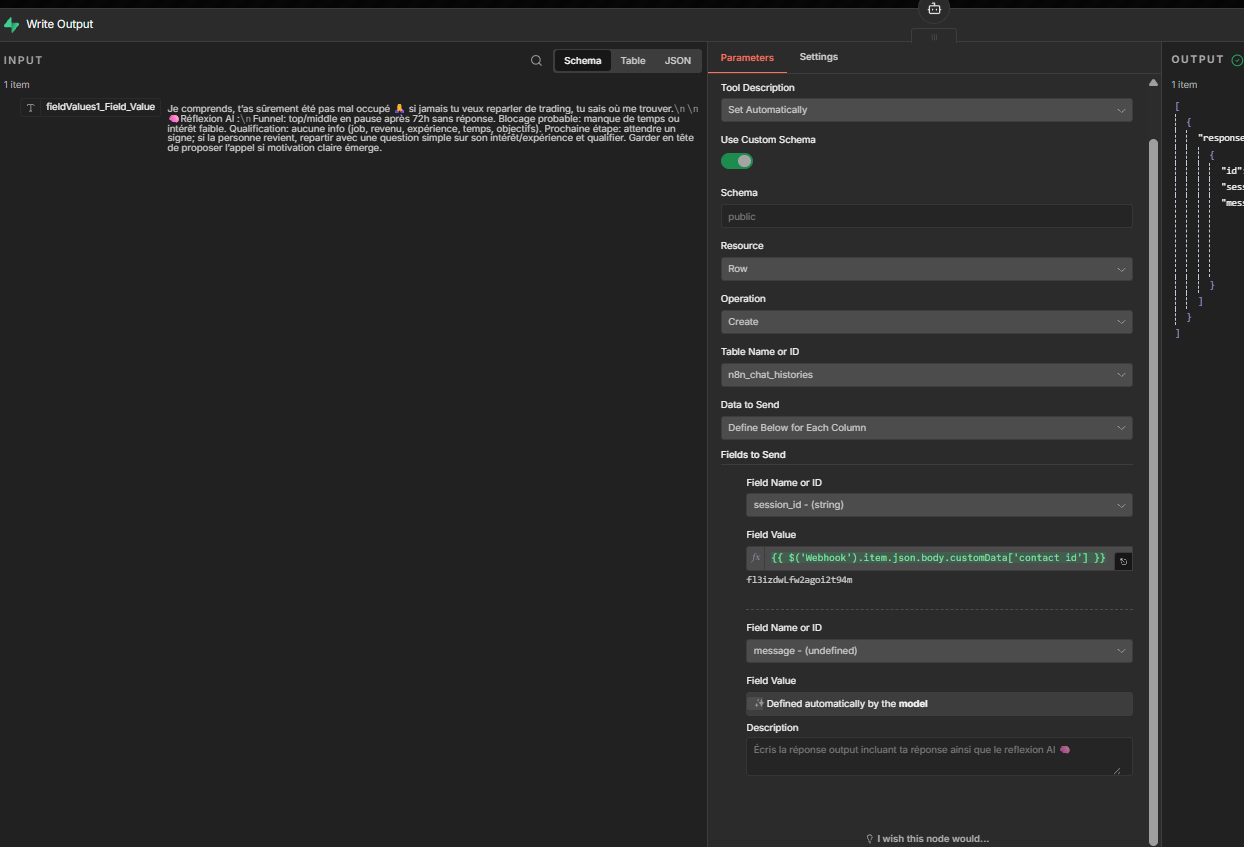

I had the same issue as you if you’re trying to use postgres as a memory for your AIs. My solution was to create two Supabase tools:
  1. The read conversation: you retrieve the number at the limit number you want of the same session id.
  2. The write conversation: you save the session id and the output of the AI and you make sure that the AI is prompted to save his output in the field. You let the AI decide what it wants to put inside.
If you prompt it well it will work the same as the postgres memory and for me it ran faster because I had a lot of timeout connection issues. Now my workflow is faster like this.
