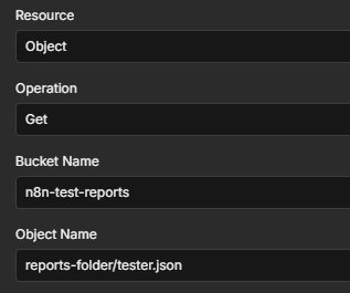

Hi,
We are trying to read a file using the Google Cloud Storage node but I cannot get it to read a file in a folder of a bucket. I can get a list of files in the bucket but I can’t “get” the object when in a subfolder. I can however in the root folder.
Is there an issue with my configuration. The file name is definitely correct but I get a 404 error,
Anybody else seen this? We can access it other ways (HTTP GET using authentication for example), but seems strange I can’t get it directly using the same node.
Here is my node configuration:
Thanks!
Version: 2.6.4
Found the issue here. Replace “/” with “%2F"
