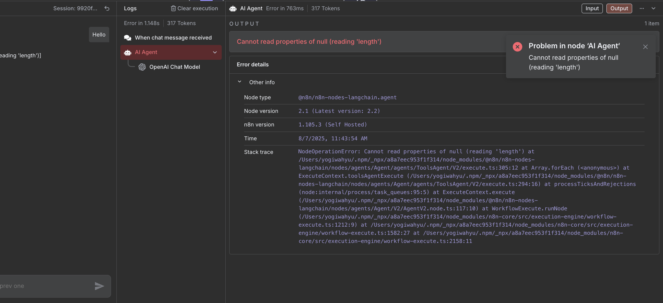

The error from n8n workflow is
NodeOperationError: Cannot read properties of null (reading 'length') at /Users/yogiwahyu/.npm/_npx/a8a7eec953f1f314/node_modules/@n8n/n8n-nodes-langchain/nodes/agents/Agent/agents/ToolsAgent/V2/execute.ts:305:12 at Array.forEach (<anonymous>) at ExecuteContext.toolsAgentExecute (/Users/yogiwahyu/.npm/_npx/a8a7eec953f1f314/node_modules/@n8n/n8n-nodes-langchain/nodes/agents/Agent/agents/ToolsAgent/V2/execute.ts:294:16) at processTicksAndRejections (node:internal/process/task_queues:95:5) at ExecuteContext.execute (/Users/yogiwahyu/.npm/_npx/a8a7eec953f1f314/node_modules/@n8n/n8n-nodes-langchain/nodes/agents/Agent/V2/AgentV2.node.ts:117:10) at WorkflowExecute.runNode (/Users/yogiwahyu/.npm/_npx/a8a7eec953f1f314/node_modules/n8n-core/src/execution-engine/workflow-execute.ts:1212:9) at /Users/yogiwahyu/.npm/_npx/a8a7eec953f1f314/node_modules/n8n-core/src/execution-engine/workflow-execute.ts:1582:27 at /Users/yogiwahyu/.npm/_npx/a8a7eec953f1f314/node_modules/n8n-core/src/execution-engine/workflow-execute.ts:2158:11
and this for the debug log from console
11:43:54.898   debug   Workflow execution finished with error { "error": { "level": "warning", "tags": { }, "timestamp": 1754541834863, "context": { }, "functionality": "regular", "name": "NodeOperationError", "node": { "parameters": { "aiAgentStarterCallout": "", "promptType": "auto", "text": "={{ $json.chatInput  } }", "hasOutputParser": true, "notice": "", "needsFallback": false, "options": { "systemMessage": "Kamu adalah asisten layanan. Jika user mengirim JSON yang memuat \"no_hp_baru\" dan \"nik_ktp\", jalankan tool `change_phone` dengan argumen persis. Jika salah satu field hilang, tanyakan field tersebut secara terpisah. Setelah tool selesai, ringkas hasilnya secara singkat dan jelas.\n" } }, "type": "@n8n/n8n-nodes-langchain.agent", "typeVersion": 2.1, "position": [432,-304], "id": "47354b03-93eb-47ec-897a-249b1cce4421", "name": "AI Agent" }, "messages": [], "message": "Cannot read properties of null (reading 'length')", "stack": "NodeOperationError:  Cannot read properties of null (reading 'length')\n    at /Users/yogiwahyu/.npm/_npx/a8a7eec953f1f314/node_modules/@n8n/n8n-nodes-langchain/nodes/agents/Agent/agents/ToolsAgent/V2/execute.ts: 305: 12\n    at Array.forEach (<anonymous>)\n    at ExecuteContext.toolsAgentExecute (/Users/yogiwahyu/.npm/_npx/a8a7eec953f1f314/node_modules/@n8n/n8n-nodes-langchain/nodes/agents/Agent/agents/ToolsAgent/V2/execute.ts: 294: 16)\n    at processTicksAndRejections (node: internal/process/task_queues: 95: 5)\n    at ExecuteContext.execute (/Users/yogiwahyu/.npm/_npx/a8a7eec953f1f314/node_modules/@n8n/n8n-nodes-langchain/nodes/agents/Agent/V2/AgentV2.node.ts: 117: 10)\n    at WorkflowExecute.runNode (/Users/yogiwahyu/.npm/_npx/a8a7eec953f1f314/node_modules/n8n-core/src/execution-engine/workflow-execute.ts: 1212: 9)\n    at /Users/yogiwahyu/.npm/_npx/a8a7eec953f1f314/node_modules/n8n-core/src/execution-engine/workflow-execute.ts: 1582: 27\n    at /Users/yogiwahyu/.npm/_npx/a8a7eec953f1f314/node_modules/n8n-core/src/execution-engine/workflow-execute.ts: 2158: 11" }, "workflowId": "v5Dy6xi4Uw1zNWD7", "file": "logger-proxy.js", "function": "exports.debug" }

Hi, I had the same error.
This issue might be of interest for you:
Probably updating your n8n might fix this.
