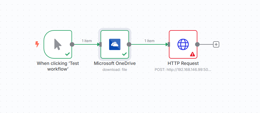

In n8n, I do this:
  1. I use the OneDrive node to download the .mp3 file into binary field data
  2. Then use HTTP Request node:
  • Method: POST
  • Content Type: Form-Data
  • Body Parameters:
    • Parameter Type: n8n Binary File
    • Name: file
    • Input Data Field Name: data

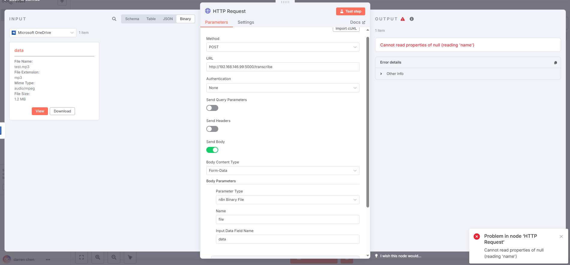

But I keep getting this error:
pgsql
複製編輯
Cannot read properties of null (reading 'name')
From the execution debug, the binary object exists, and contains the file under data.
I’ve also confirmed the binary field contains the proper metadata (filename, mimeType, fileSize). There are no intermediate nodes removing binary data.
:red_question_mark:What I’ve tried:
  • Ensured OneDrive output binary field is called data
  • Used a Set node with “Include Binary Data” to confirm the file exists
  • Checked raw execution JSON – binary.data is present
  • Tried manually specifying another binary field name → same error
Any ideas what could be causing this mismatch, or anything I might be missing in the HTTP Request configuration?

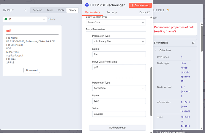

Hallo Darrin, Any luck finding a solution to your problem? I am facing the same issue sending a pdf file to an (Accounting Program API - lexoffice) after updating from version 1.90.1 to 1.104.1.
I am using n8n-community under ubuntu24.04 / via NPM / Postgressql / Redis
