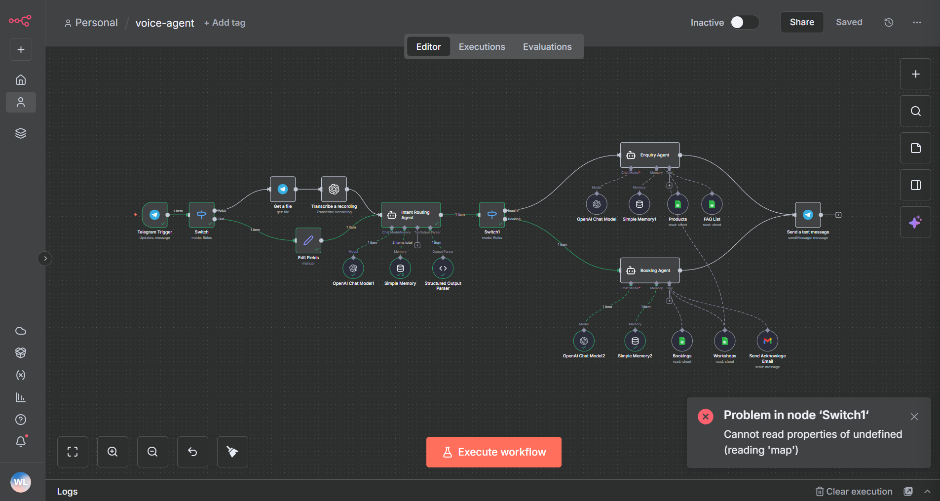

Cannot read properties of undefined (reading 'map')
I’m getting this error when I try running of my agents. Other agents within the same workflow don’t have this error
“errorMessage”: “Cannot read properties of undefined (reading ‘map’)”,

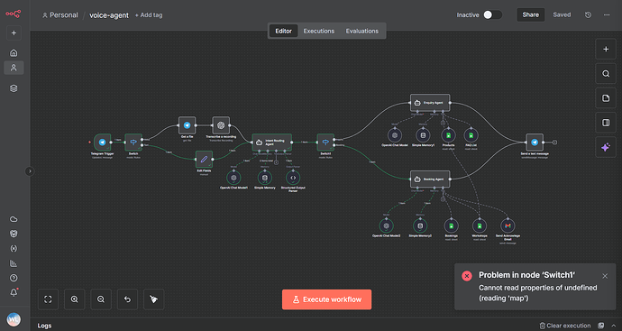

I am having the same issue, it is so frustrating that it works for my Enquiry Agent. However, it sometimes works and sometimes doesn’t work for the Booking Agent. Can anyone please help?
