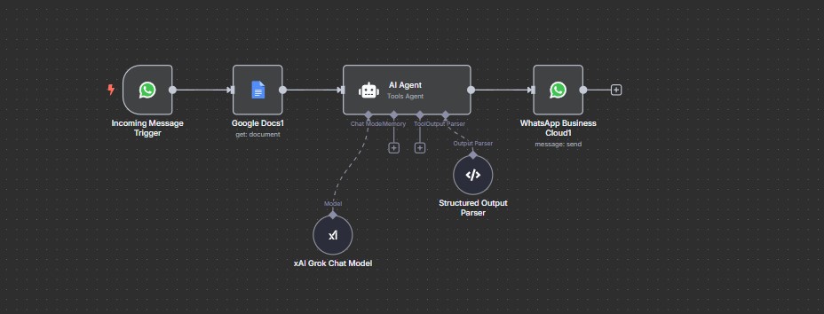

Hey everyone, I’m running into an error with the WhatsApp Business Cloud node that says: Cannot read properties of undefined (reading 'replace'). I’m trying to send a message using data from an incoming WhatsApp trigger, and I’ve set the recipient’s phone number using {{$('Incoming Message Trigger').item.json.contacts[0].wa_id}}. I have tried the metadata one, but I’m not sure why this error keeps popping up. Has anyone seen this before or know what might be causing it? Would really appreciate any help!

Here’s the workflow so yeah I am really confused why this error is coming
Plus the main problem is that it works as a test workflow but when I activate it and than test it it doesn’t

My by try use “from” propery instead: {{ $(‘WhatsApp Trigger’).item.json.messages[0].from }}
