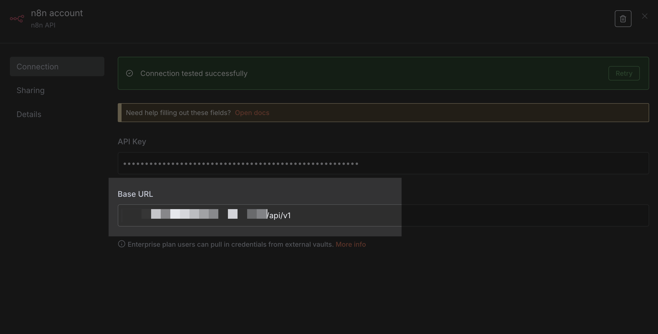

The base url should be your n8n cloud endpoint with /api/v1
Can you check the setting from the n8n node credential?
