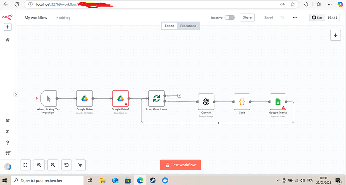

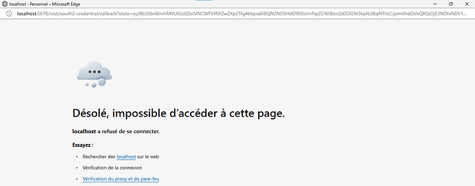

i want to connect google app into n8n nodes at first all goes right but this show up
it says : sorry, u cant access this page and localhost refused to cennect
am on 1.82.3
windows 10

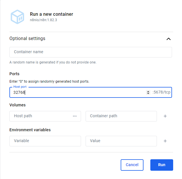

Sounds good, when you go to your docker app did you start your container? If you did on which port? As in video was mentioned, try to change the port from 5678 to 5680 and then access it http://localhost:5680
YUP i did sir
but does it has to be 5680??

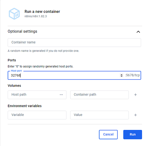

Can you take a screenshot of your Docker setup? Specifically, the page shown at 2:11 in the video I shared earlier.
But first, please try to access your instance at the address http://localhost:32768
