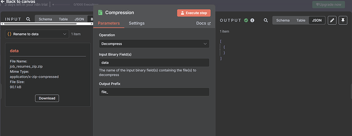

I’m trying to decompress a ZIP file using the Compression node on n8n cloud. The node executes successfully and receives the ZIP file (90.1 kB), but it outputs only 1 item with empty JSON instead of extracting the 3 PDF files that are inside the ZIP. The same workflow works perfectly on my local n8n instance (I used code on my local n8n host instead of this node as it was not working there as well. The code in my local n8n node was not working for web.)
No error message - the node shows “Node executed successfully” but doesn’t extract any files.
output returned by the last node
Input: 1 item with binary data
  • File Name: job_resumes_zip.zip
  • Mime Type: application/x-zip-compressed
  • File Size: 90.1 kB
Output: 1 item with only empty JSON [{}] Expected: 3 items, each containing an extracted PDF file in binary format
Database : Cloud managed
n8n EXECUTIONS_PROCESS : Cloud default
The ZIP file contains 3 PDF files (resumes)
Additional info:

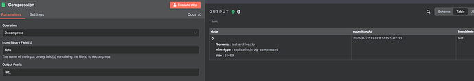

I tried decompression and it worked fine (n8n cloud):
Doesn’t work with n8n form…

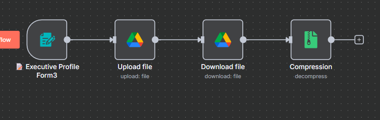

I am facing the same issue from form submission. I was able to get this working by adding a intermediatory step of uploading and downloading the zip from google driver

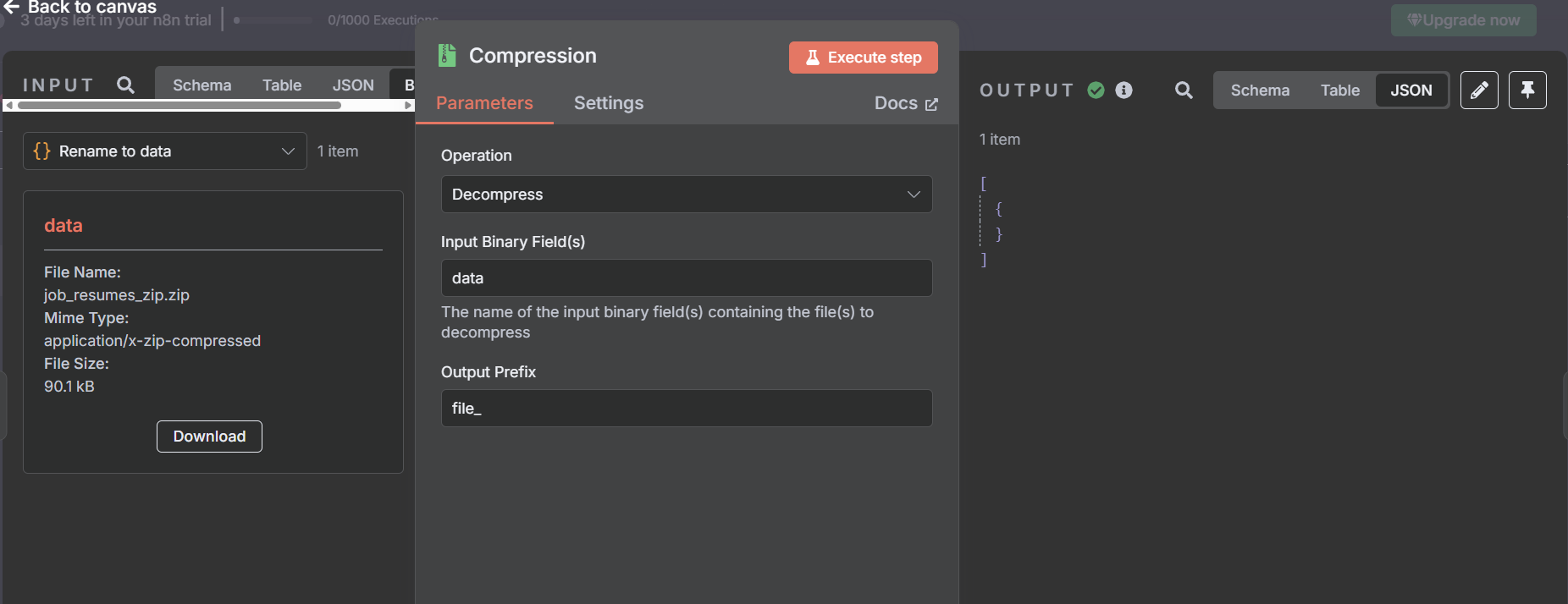

I had similar issue. The decompression was not working. What fixed that was changing mime type, filename and extension to zip in a CODE JAVASCRIPT node before decompression like this:
for (const item of items) {
  if (item.binary && item.binary.data) {
    item.binary.data.mimeType = 'application/zip'; // or any MIME type you need
    item.binary.data.fileName = item.binary.data.fileName + '.zip';
    item.binary.data.fileExtension = 'zip';
return items;
