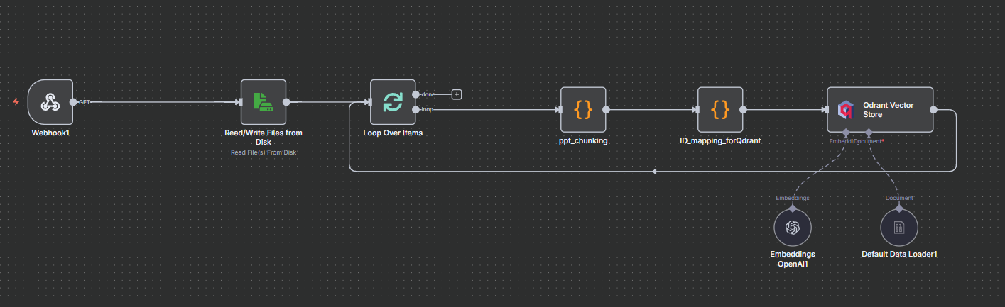

Workflow Blueprint: If you look at the screenshot, you can see the first part of the workflow, the RAG. I intented to create a knowledge base of two books of references (pdf files) + one ppt slide of a previous teaching mission of mine. I thought this way, the AI agent can tap in these two authoritative books for knowledge harnessing and mimic my teaching and presentation style from my ppt slide.
So far what i did, based on the strategy suggested by the LLMs, is a python script that turns the PPT file and as much metada as possible into a jsonl file called “slides.jsonl”, after which another script would break this jsonl into smaller jsonl (3), then the webhook trigger kicks in.
Note: Breaking the file into smaller pieces was an LLM’s suggestion to fix my main issue but it didn’t help.
Webhook → Read/Write files from disk (this will output all 3 files) → then a loop that takes the files into a ppt_chunking Code node, but one file at a time. This was also a suggest to try to control the flow of data downstream to fix the main issue which is downstream.
The ppt_chunking runs a python script that is supposed to chunk the jsonl files. The data is then sent downstream to the Qdrant Vector store.
The Qdrant Vector store has two child nodes, an emmbedding OpenAI and a default Data loader node.
Finally, my problem : Every time I reach the Qdrant vectore store step. It never ends, it takes forever to fill my Qdrant collection. While monitoring the Qdran dashboard to look at the counters of my collection as it is filled up, i see dozens if not hundreds of thousands of points being created. It never stops untill such a point where i hit the following error:
FATAL ERROR: Reached heap limit Allocation failed - JavaScript heap out of memory
After which the n8n instance just crashes.
