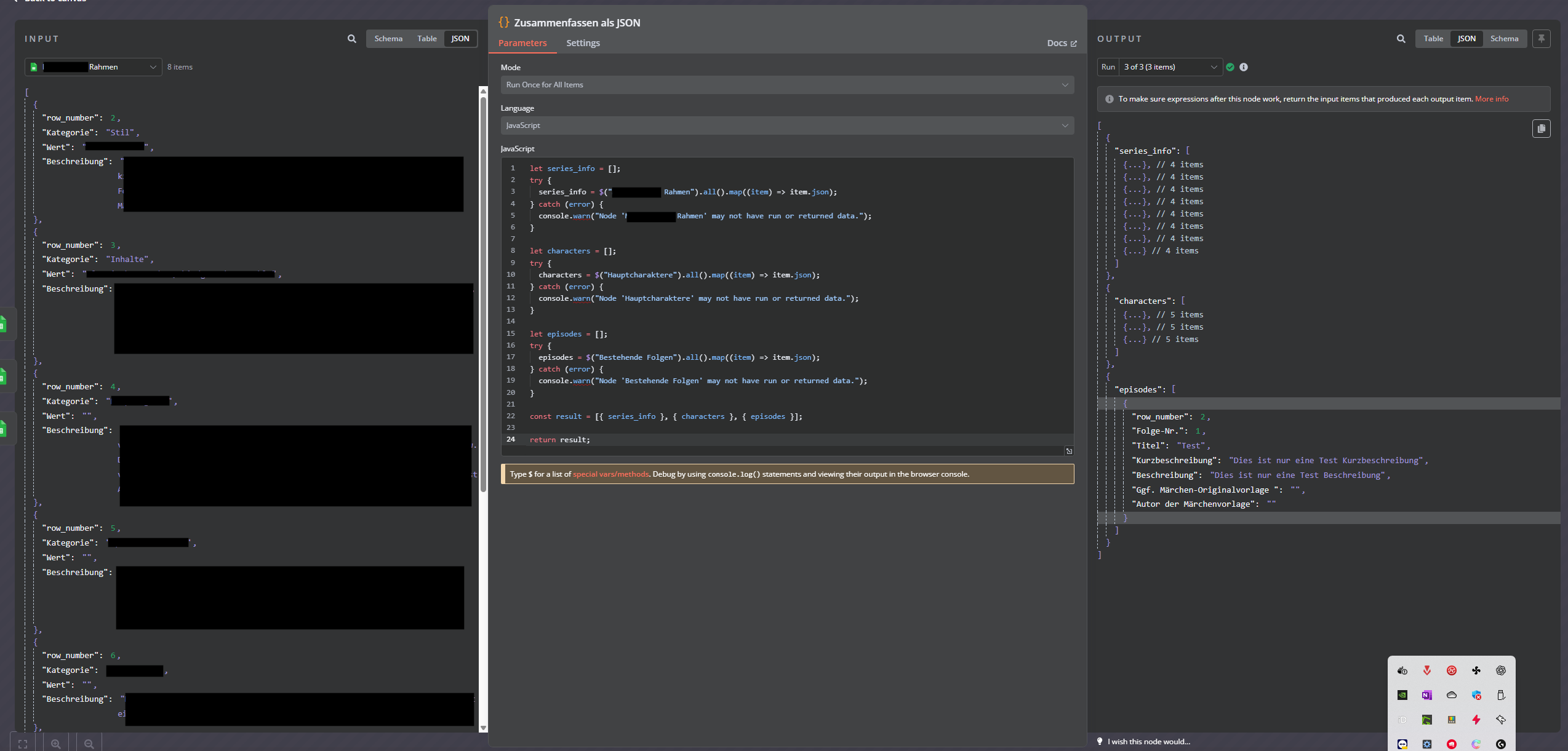

I have a google spreadsheet doc where I want to read 3 different table spreadsheets from. Since for the standard AI tools agent you can only specify 1 spreadsheet in a doc, I’ve created a sub workflow which reads all 3 spreadsheets seperately, and then brings them into 1 correctly formatted JSON using Code node + JS:

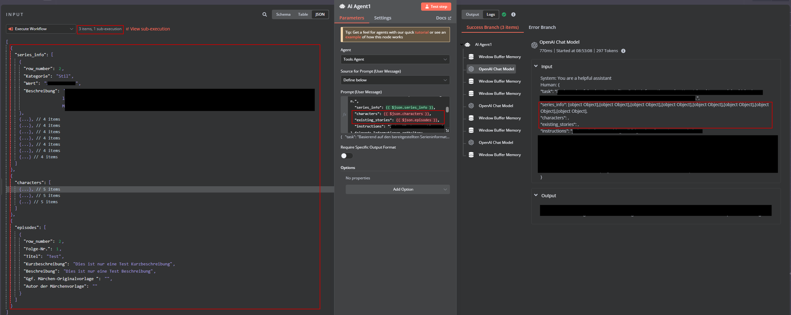

In my main workflow I have an AI agent which this JSON should be passed to, and each of the 3 data parts should be used for a prompt. I refer to it using the standard json expression.
My Problem:
Already in the view where the prompt is defined, the last two parts (characters and existing_stories) are marked red, so it does not seem to be referenced correctly. This can also be seen in the execution of the AI agent.
I have 2 problems there:
- the contents from the first part (series_info) are only referenced as [object Object],[object Object], etc.
- the last two parts (characters and existing_stories) are completely empty
