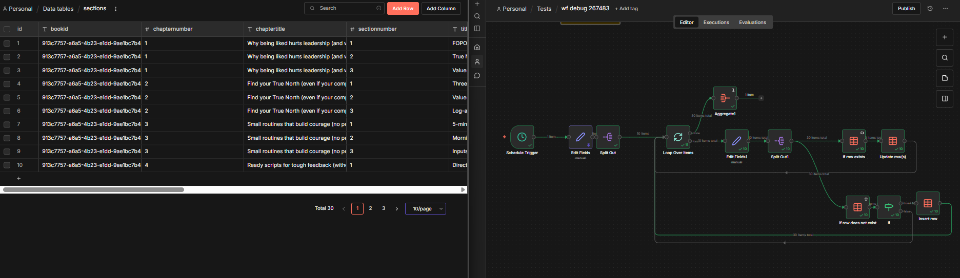

hi @djjace I ran the exact same wf keeping only the pinned data from “edit fields“ and it worked well with a single output after the aggregate node :
JSON wf attached : can you run the same and let me know the output ?
wf debug 267483.json (72.3 KB)

Hi @djjace,
I can guess what’s wrong with this workflow, the Split node inside the loop outputs two branches, and each branch loops back, that explains why in the end the Aggregate node doesn’t return a single item..
The solution would be to use a Merge node so that we get only one loopback branch, keeping the loop logic correct,
However, I personally wouldn’t do that because it would make the workflow more complicated than necessary,
Usually, the first thing that comes to mind when I see a loop node is: Do I really need a loop?! Most of the time, the answer is probably not,
So instead, let’s try removing the loop and designing the workflow without it, since n8n already loops through items by design,
Here is what the workflow looks like without loops:

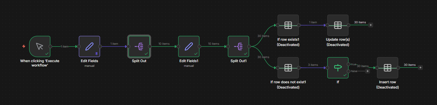

hi @djjace I believe the wf json you shared and that I ran is not exactly the one you’re using because in my wf execution it goes to the node “insert rows“ and output 30 items :
But on your case it goes into the node “If1“ and outputs 10 items :
Can you pls provide this latest wf json you’re using ?
