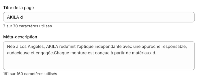

I’m currently facing an issue: I want to perform a PUT request to update some metafields, but when a metafield is empty (i.e., hasn’t been created yet), I can’t retrieve its id.
Here’s an example:
In this case, I updated the title successfully, but the description remains the same as the product description — meaning it’s empty.
As a result, the response only includes the id of the title_tag metafield. The description_tag metafield is missing because it doesn’t exist yet.
