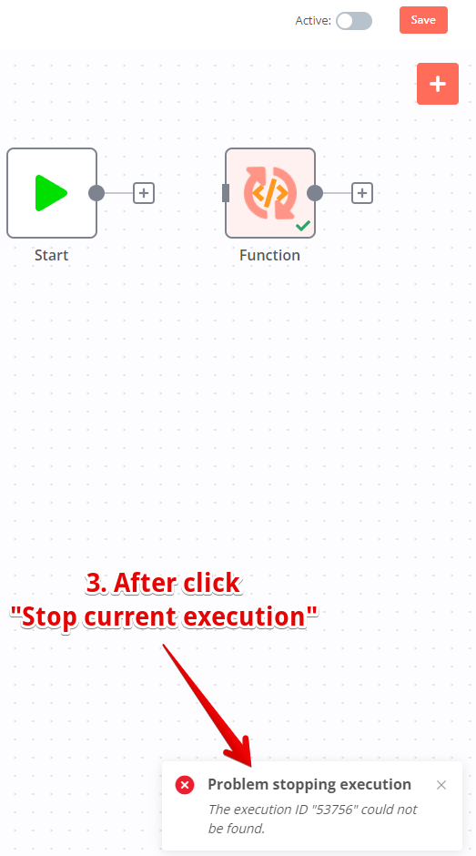

Hi all!
Installed NPM (https://www.npmjs.com/package/zadarma) to integrate with an external CRM system, but can’t get any data from it.
The function node does an infinite execution and nothing comes back.
I ask the community for help.

Hi @Roket, the Connection lost error suggests that your n8n server has become unavailable.
Can you check your server logs? Did n8n crash by any chance?
Hey @MutedJam , the Connection lost occurs briefly. Everything is fine with the server.
