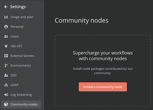

Now, I try to install a community node:
https://www.npmjs.com/package/@digital-boss/n8n-nodes-billrun-suitecrm?
Via settings - community nodes and then I receive an error:

Hey @Chris7935 , to install a community node go to Settings → Community nodes to install it.
Yes, that’s what I did.
And then I got this error there.
