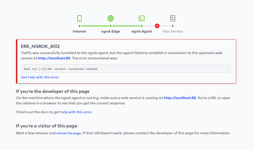

I’m trying to run n8n via docker with ngronk, however it seems i’m having some troubles with port numbers. I get this error message when going to the free domain given to me by ngronk on my Firefox browser. Running localhost:5678 works fine, but not the domain.

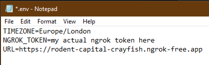

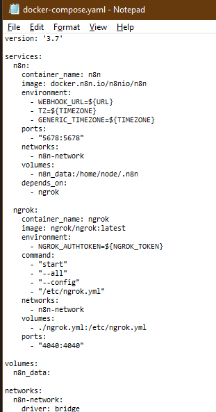

Here’s how the .yml and .env files look like:
The edges page on ngrok shows that 1 tunnel is active.
I run this whole setup with docker.

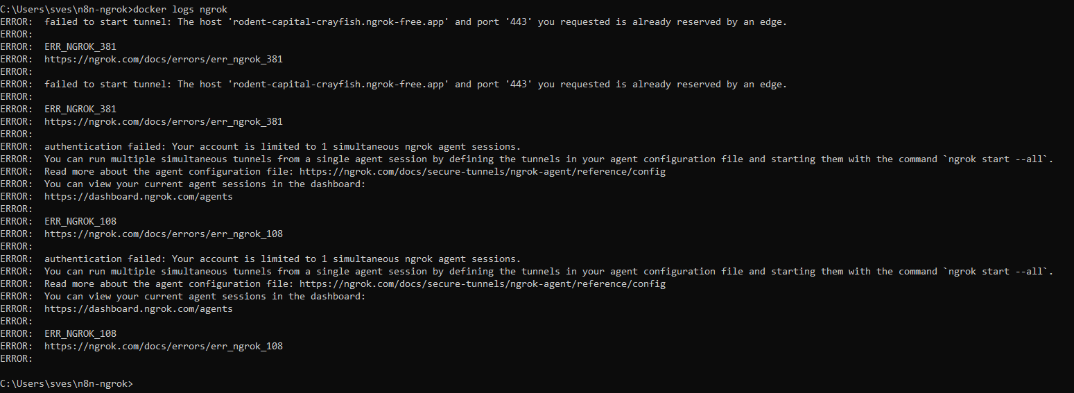

“docker logs ngrok” in terminal drops a whole bunch of errors, i don’t know how related they are to this.

ngrok seems to think your account is already running a tunnel and it looks like your account is limited to just the one so you may need to check in the ngrok ui to see if you have another one running that shouldn’t be.
The browser error would suggest it is being used to serve something running on port 80 that isn’t running, did you manually install ngrok as a service at some point?

Hi sves, I’m from ngrok Support and wanted to try to help here. If you are having trouble, please feel free to contact us from the ngrok website for further help!
With ngrok you connect to Edges differently than starting a direct tunnel.
In your case, the easiest thing here will be to actually delete the Edge. You don’t need an Edge to use the domain, if it’s defined in your ngrok.yml, it just needs to be reserved to your account.
Also if you are using docker desktop with windows, you may need to enable host network in Docker Desktop itself (Docker Desktop version 4.34 and higher).
