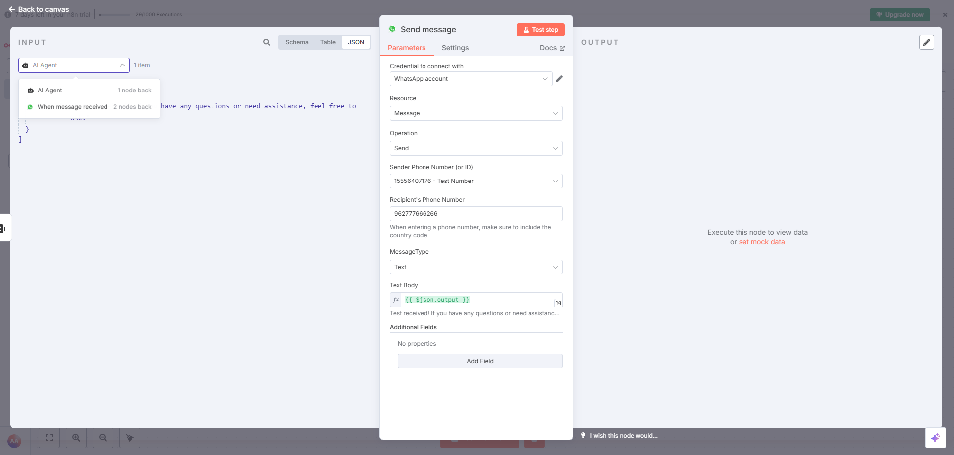

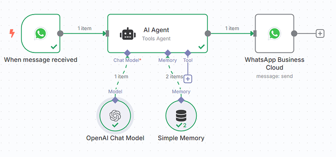

Hey all, this is a very simple workflow:
In the last step ‘Send message’ I am trying to include the number of tokens used by the ‘chat model’ in the ‘AI Agent’ step.

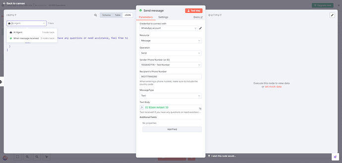

As you can see {tokenUsage.totalTokens} isn’t available as an input:
How can I access the output of the ‘OpenAI Chat Model’?
Thanks,

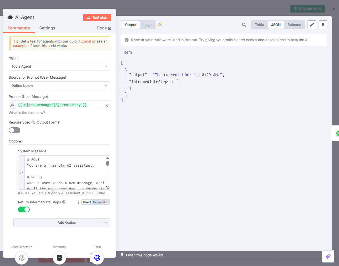

Hi @aminabudahab
You will need to activate Return Intermediate Steps
in the AI Agent node options
Much appreciated, I have enabled the option and I can see the object ‘intermediateSteps’ is added to the ‘AI Agent’ output but it is empty:
What am I missing?
Thanks again
unfortunately, It seems that this feature involves intermediate steps performed by the model, but the main process is currently not possible…

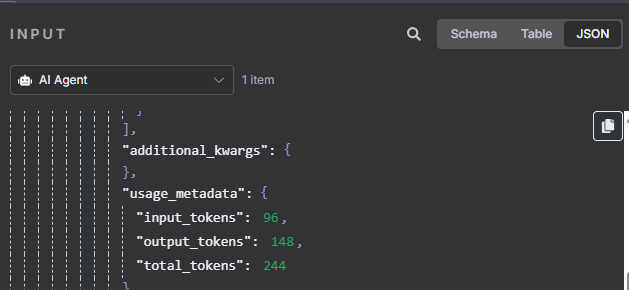

I was having the same issue. There’s a workaround that works pretty well.
Take a look here

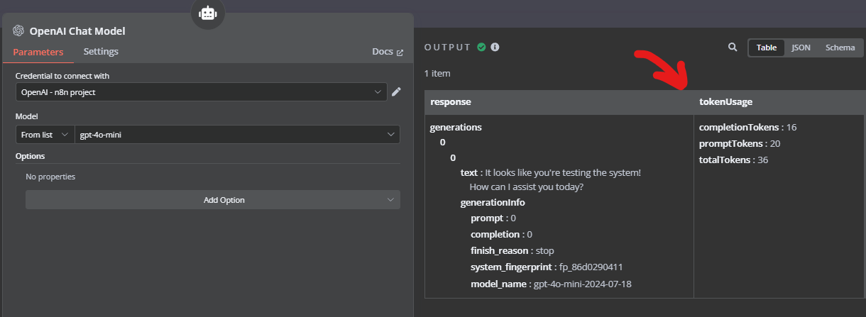

How can I get this information? It’s shown in the chat model, but I can’t access this data in my workflow.
[image]
I’ve seen workarounds here in the community, but maybe now there’s an official way?

EDIT: Solution Found …
