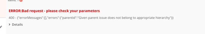

As @harshil1712 already mentioned, the parent parameter is only considered when the issue type is a subtask. If I send a parent id with any other issue type, it errors—see the image below. Not sure why you are getting the error. It works fine for me when the issue type is a subtask. Do you have any sort of message in error aside from 400?
Yes I can create a Subtask with the parent as a Task. Apparently I can’t create a Task with the parent as an Epic and obviously no Subtask with an Epic as the parent too because of the hierarchy structure. However, the Epic does not count as a “parent” for the Tasks then?
Anyway, can you think of a workaround to add/update a Task for relating it to an Epic? Would be very helpful…
