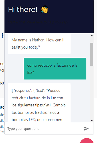

Hi, I created a chatbot and now i want it to run on my website. So I published the workflow and set the chatbot node to “embed”. It’s working, but the chatbot on my website returns JSON Code, not only the AI Answer (see image)
If I use the chat trigger in my workflow, it works fine.
N8n Self hosted with Docker on Digital Ocean, Version Version 1.52.2

What does the end of your workflow look like? If you use a Set Node for example you can specify a key value with the name of either text or output and set it to the AI response. The Agent will then pick that up and return only the response text.
Here’s an example of what I mean:

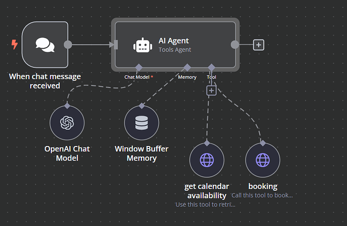

Hi @holgerkurtz92. I encountered the similar problem. The chatbox output with {“response”:{ “text”:
Here’s what work for me. Below is the workflow I’m using

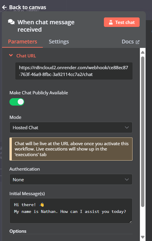

Embed below script in the website. Link to script ( @n8n/chat - npm (npmjs.com)
Replace ‘YOUR_PRODUCTION_WEBHOOK_URL’ with your chat URL
That should get rid of {“response”:{ “text”: . Let me know otherwise
