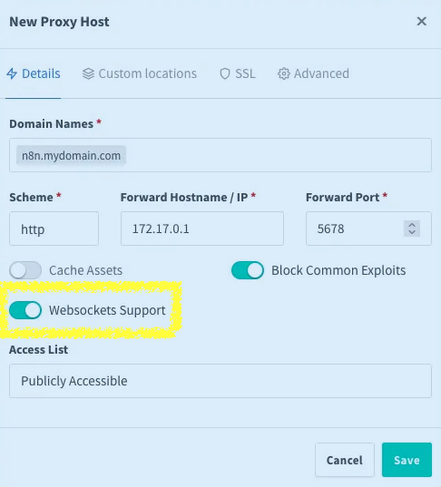

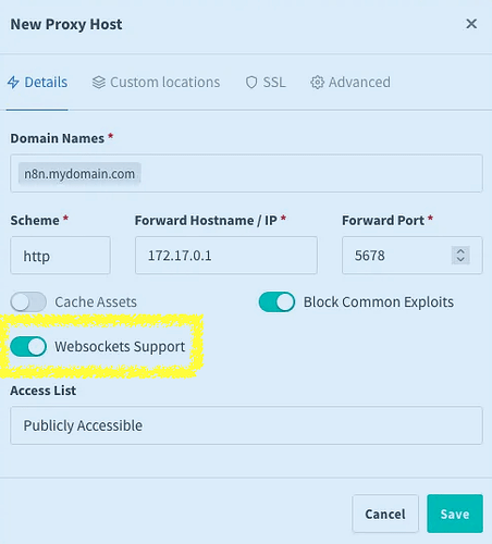

aha! That’s an important piece of information :wink:
Can you check that you have websocket support activated in your nginx proxy manager?
I don’t use nginx proxy manager, I do everything in the CLI…
For those not having n8n showing the reply at the chat you have to activate two things having nginx:
proxy_buffering and as @ria is saying: Websockets. and this is how I did it. Thank you Ria. this is my content of my nginx /etc/nginx/sites-enable/yourfileconfile
