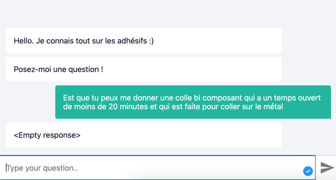

I am playing a bit with the new Chat Node. I built a small POC for document retrieval which works as expected in n8n.
However, using the “hosted chat” I get “empty response” while in my log I have a response. What could be the issue ?

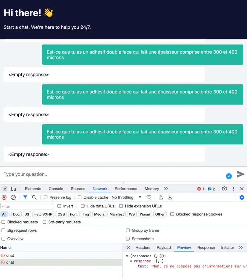

After more investigation, I can see the response is received (in the chrome dev tool), but not displayed in the chat.
How are we supposed to format the response to be displayed in the chatbox ?
Hi guys, I`m with the same problem described above. Could you please help us?
Maybe somebody with a working chat window (if there is), could show us the response of the chat query in the Chrome dev tool ?

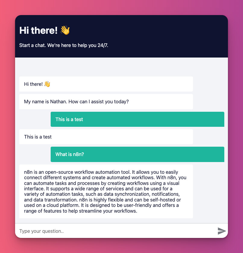

Do you get the same issue when using an AI Agent? I have just given it a quick go and it seems to be all good using the workflow below.
This indeed worked with a AI Agent.

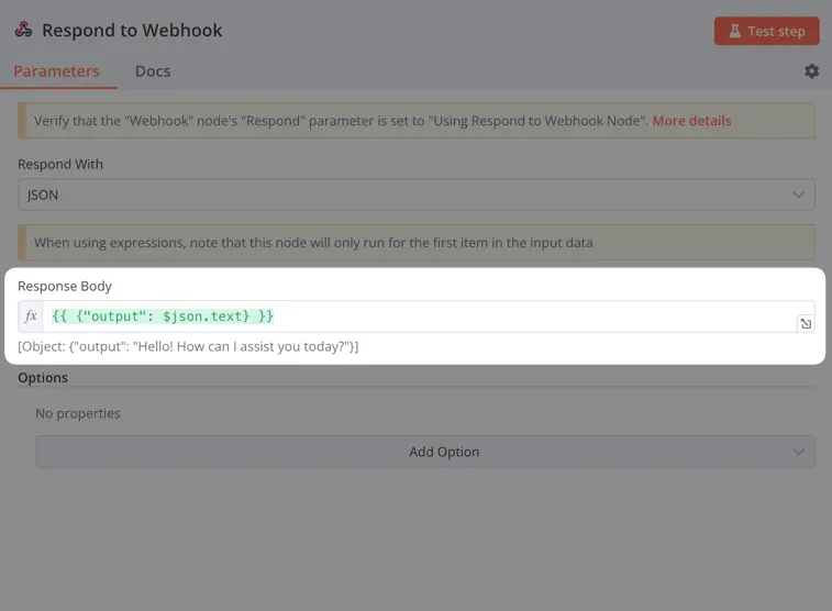

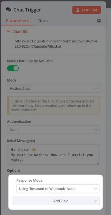

So I could inspect the response and make it work with a Basic LLM but it is definitely a bit tricky and should be improved or documented.
Here is the trick:
