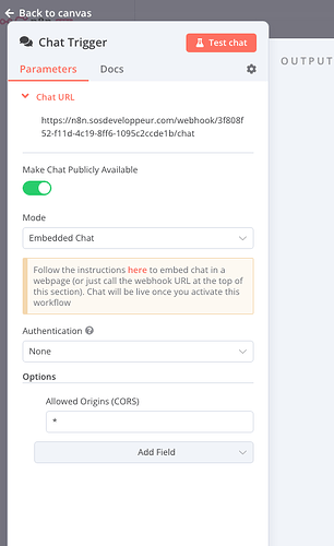

The “Respond to Webhook” should not be needed in this case. So instead of setting
  • Response Mode: “Using ‘Respond to Webhook’ Node”
you can either
  • delete the option
    or
  • set Response Mode: “What Last Node Finishes”
It should then work fine. By the way. I assume that is what @Jon meant. Not just disconnecting the node, but rather changing the setting on the Chat Trigger node.

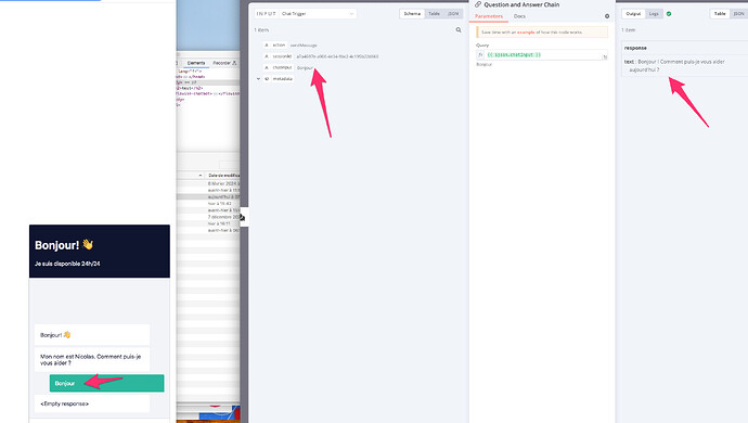

I have already removed the option…
As I said, it’s working well with “Agent AI” but not with “Question and Answer chain”.
I don’t know why
I have the same problem that @romeo_roy the response is return by the server, but not in the UI. I think that the response format ({ “response”: { “text”: “…” } }) is not interpreted by the webbrowser interface in the “chat”. whereas with the Node “Agent AI”, it’s works fine : the response is “output” or “data.response” directly…
