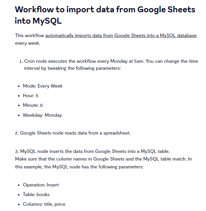

it is possible but it is not easy, we don’t currently have a trigger for Google sheets so a couple of options would be to use a google app script to post to a webhook that n8n picks up on any changes or on a schedule read the entire sheet and the database and work out what is missing / added using a couple of merge nodes.
This blog post might help with a bit of it: How to connect Google Sheets to MySQL – n8n Blog

Hey @daniel.o
Yeah that would be possible, It is not much different from the second workflow in the link. You would just need to start with a MySQL query to delete your database.

Hey @daniel.o,
That is fine, How did you get on with building out that workflow? In theory it would be just as you have written it so as a basic structure you would want to start with something like the below, You would just need to work out what If statement to use to work out if you have data or not.
