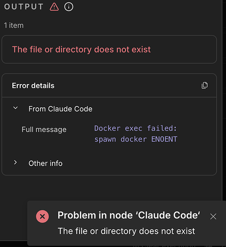

Followed your quick start instructions (claude-code-runner using docker), successfully authenticated with Claude login, Claude Code and n8n are running on the same Linux server. Which file or directory is it referring to that doesn’t exist?

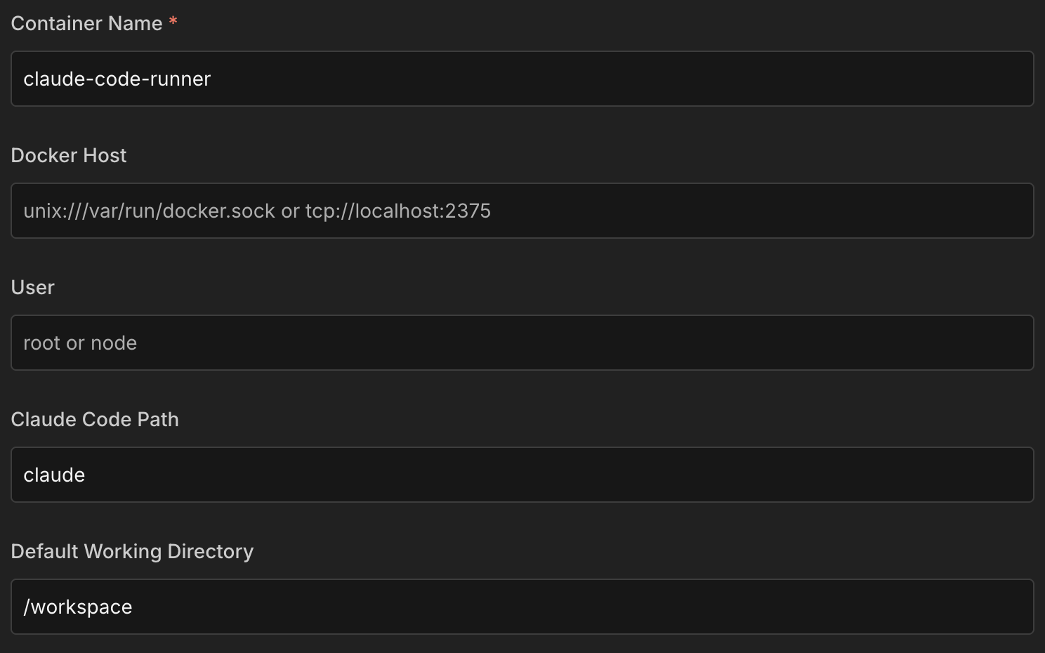

Hello @Benwhut, do you have a “workspace” folder inside your claude-code-runner’s container ?
If not, you need to create one named workspace, liked your configuration or name it as you want.
Have a great day !
I can see a “workspace” folder inside my “claude-code-runner” folder and the docker-compose.yml file has this line:
- ./workspace:/workspace
Am I running into issues because I am using docker containers for both n8n and claude-code-runner? Is this the problem?

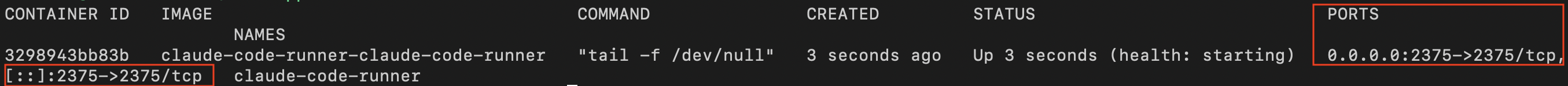

I noticed the claude-code-runner container doesn’t appear to have a port when following your quick start guide.
Screenshot 2026-01-07 at 10.04.45 AM
So I added this to the docker-compose.yml file:
ports: [“2375:2375”]
and the container then shows the port
but after restarting the claude-code-runner container, I still get the same original error message in n8n. Any other suggestions?
Hey! The issue is that this node doesn’t use HTTP communication between n8n and claude-code-runner. Instead, it uses docker exec to run commands inside the container.
How it works:
n8n → docker exec claude-code-runner claude -p "your prompt" → response
So you don’t need to expose any ports on claude-code-runner (remove the ports: ["2375:2375"]).
What you need instead:
If your n8n is running inside a Docker container, you need to mount the Docker socket so n8n can access the Docker daemon:
# In your n8n docker-compose.yml
services:
  n8n:
    volumes:
      - /var/run/docker.sock:/var/run/docker.sock
Also make sure both containers are managed by the same Docker daemon (same machine/docker host).
Quick checklist:
  1. Remove the ports config from claude-code-runner (not needed)
  2. Add Docker socket mount to your n8n container
  3. Verify: docker exec -it n8n docker ps should show claude-code-runner
  4. In n8n credentials, use container name: claude-code-runner
