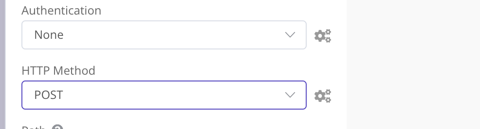

Is it possible that the webhook uses the HTTP Method GET, and ClickFunnels sends a POST? Can you try setting the HTTP method to POST?
Tried with POST but get the same error
