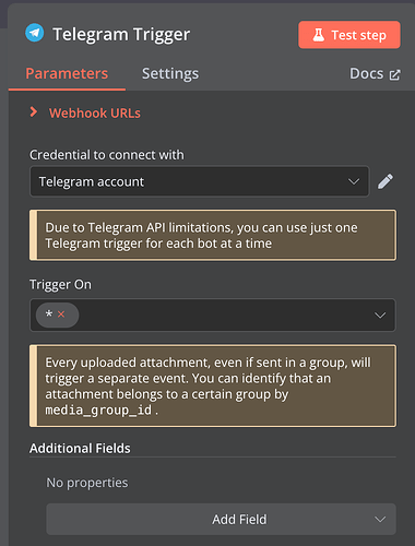

tried “Trigger on” * , message … but all the same. Don’t receive any messages.

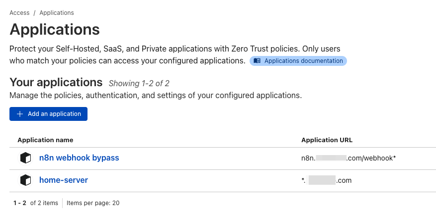

I have been having the same issue where the Telegram trigger is not “triggering” - my self-hosted n8n is protected by Cloudflare with OTP or OIDC, access the n8n application works no issue, but the trigger is not working. Got the Webhook configured in the docker environment, and it turns out to be authentication issue of the webhook - for example if you host https://n8n.yourdomain.com/, you can still protect your application with your desired method, but you will need to allow authentication bypass for the URL Site similar to backpage | sites like backpage | new backpage - bedpage.com* in Zero Trust > Access > Application and add an application specifically with the n8n base URL including the “webhook*” PATH, the policy action should be “BYPASS”.
This works for me and now Telegram message trigger works fine while the base n8n URL will still need to authenticate with Cloudflare.
Thank you @codylo for the clear instruction. This works for me perfectly!
EDIT: I set the “Action” to be “Allow”. Set it to “bypass” solved the problem.

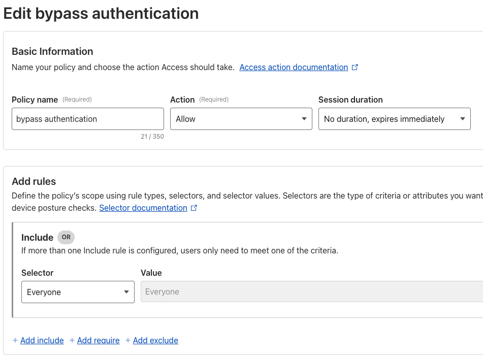

It didn’t work for me.

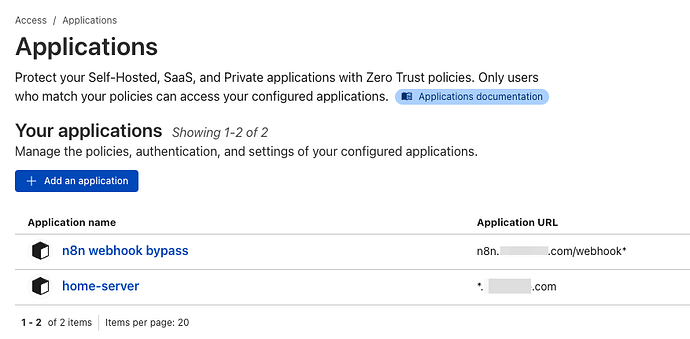

As you said, I created a new application for the specific webhook path.
And I added a policy to allow everyone (I don’t know what you mean “BYPASS”):
