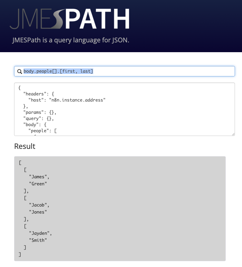

Code and/or JMESPath bug?
I’m getting the following result:
Whereas it should be:
As well as according to the n8n documentation:
n8n version 0.209.4
works fine in the Set node …
{{ $jmespath( $json.body.people, "[].[first, last]") }}
Although I still think that this may be a bug, I figured out that it does work when you add keys …
return $jmespath($input.all()[0].json.body.people, "[].{firstName: first, lastName: last}" )
Please not that if you’re using the JMESPath query (https://jmespath.org) to remove the “” around the key.
So [].{"firstName": first} in JMESPath needs to be [].{firstName: first} in n8n … both the in the Code and Set node
