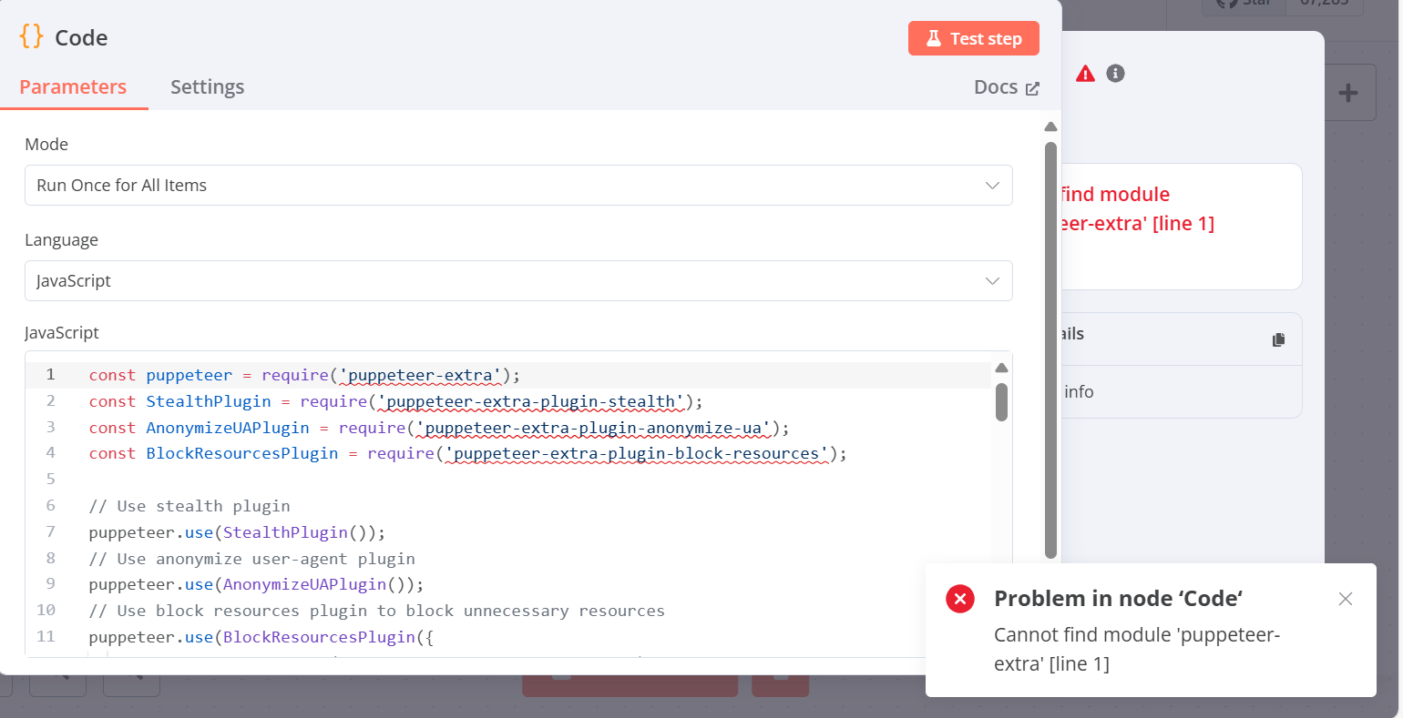

I am having an error in my code node require external module. i need puppeteer. i know there is a puppeteer community node, but its not working from me for some reason. so i am trying to just run it in a code node instead.
Error:

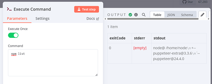

I tried to npm install in the /home/node which you can see in an execute command node npm list. i am not sure what im doing wrong.

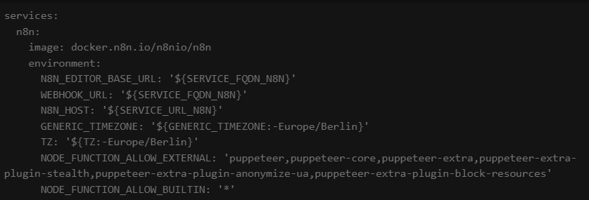

Environment Variables:
  • n8n version: 1.81.4
  • n8n EXECUTIONS_PROCESS setting (default: own, main): not sure, selfhost
  • Operating system: linux selfhost

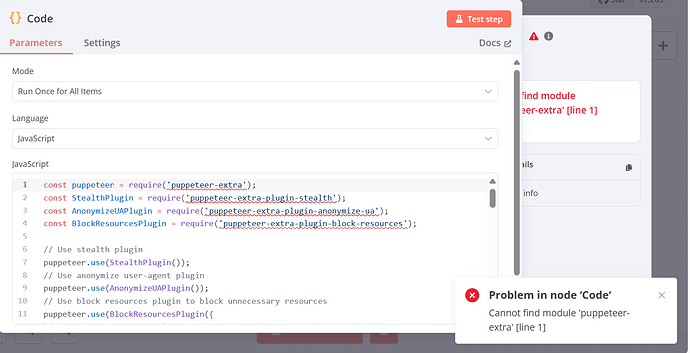

@ThinkBot hey thanks for your response. i tried to restart my container, and even redeployed also. but it is the same error, cannot fine module puppeteer when running the code node.
one thing though, when i try to restart my container, i needed to install npm puppeteer again. is that normal?
This may help further:
i cant get this working. i’ll just deploy a script and call it via api in an n8n workflow :confused:
