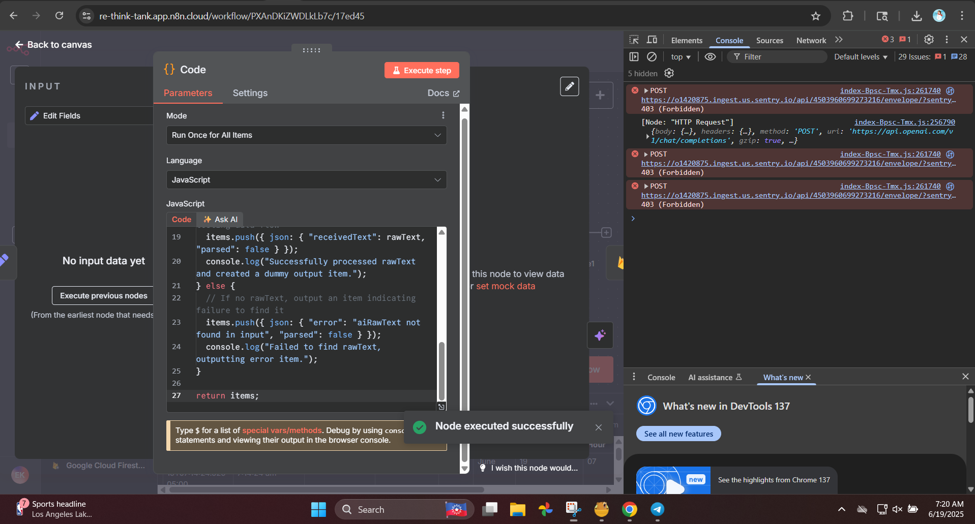

The workflow proceeds successfully up to an “Edit Fields” (Set) node. The n8n canvas shows a “1 item” indicator on the connector leaving this “Edit Fields” node and entering the subsequent “Code” node. However:
  1. When inspecting the Code node’s “INPUT” panel in the workflow editor (even after clicking “Execute previous nodes”), it shows “No input data yet.”
  2. More critically, when running the entire workflow and checking the detailed Execution Logs for that run, there are no console.log() messages from the Code node , even when the very first line of the Code node’s script is a console.log() statement intended to log the received input. This indicates the Code node’s script is not being entered/executed.

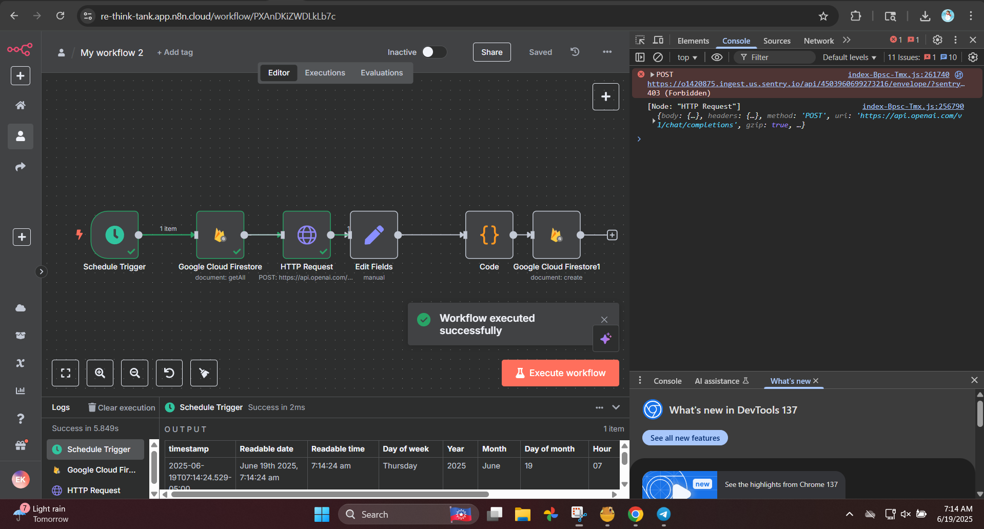

  3. The workflow visually “stops” at the Code node (no green checkmark, no data output indicators on the canvas).

when “My workflow 2” is run:
  • The HTTP Request node successfully gets data from OpenAI.
  • The Edit Fields (Set) node is configured to extract choices[0].message.content into aiRawText.
  • The canvas shows “1 item” going from Edit Fields to Code.
  • No console.log messages from the Code node appear in the Browser Developer Console.
  • The Code node does not produce output.
  • Your test workflow did produce console.log messages in your Browser Developer Console from its Code node…where do I go from here?
  1. “I ran my main workflow (‘My workflow 2’) again.”
  2. “The HTTP Request node runs successfully.”
  3. “The ‘Edit Fields’ (Set) node (which extracts aiRawText from the HTTP Request output) also gets a green checkmark and shows ‘1 item’ on its output connector on the canvas.”
  4. “The Code node has a simplified debugging script starting with console.log("Code Node Input Item:", JSON.stringify($input.item, null, 2));.”
  5. “When I run the full ‘My workflow 2’ and check the Browser Developer Console , there are NO console.log messages from this Code node .” (You can share this latest screenshot showing the browser console).
  6. “This is different from when I ran Sudhanshu’s test workflow, where his Code node did produce console.log messages in my Browser Developer Console.”
  7. “In my Code node’s ‘Settings’ tab, ‘Execute Once’ is OFF, and ‘On Error’ is ‘Stop Workflow’.”
This comparison clearly shows that data flow into a Code node and its subsequent script execution (at least logging) works in a minimal new workflow on your instance, but fails in your existing, more complex workflow, even after inserting the “Edit Fields” (Set) node as an intermediary.
