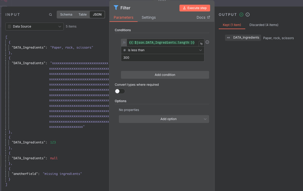

Regarding the code above. If this is the only content of the code node, you could easily change it to the filter node.
Something like this?
Thank you again @jabbson !

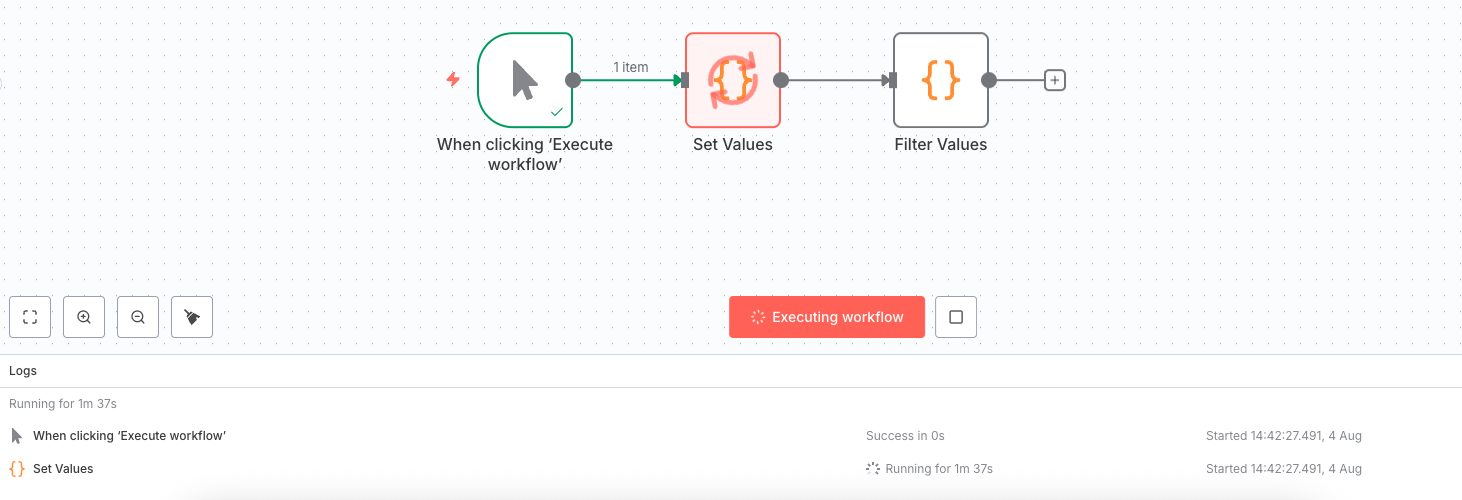

So, if you tried to run the following workflow:
Would it fail for you?
I tried running the workflow you provided. And it does not run. It gets stuck on the first code node :frowning:
I am sharing the image below just fo reference. I stopped it after a few minutes of running.
